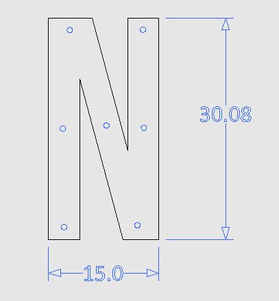

So I'm new to using pad mounts on acrylic letters. Not sure how man pads are needed. Here is a 30" tall letter out of 1/2" acrylic to be mounted outside on brick. Would six 1" pads be enough and should only the top two have pins into the brick to allow expansion? could you pin mount 1/4" thick acrylic this size or would it be too wavy? Any advice would be apprecated

You have 7 drawn, not 6, but I would go with 7, like you have shown.
I don't understand your question about the top ones having pins into the brick & expansion......all 7 should have studs.
1/4" acrylic would be a bit thin for letters this size.
All of that being said, any particular reason you're not just drilling and tapping them?

Ahh, yes 7, was a long day. Just thought gluing pads to them would be faster. Hadn’t considered drill and tap, worried I’d blow through the face with the tap.

Drilling and tapping is the most common method used (almost always).
Transporting a bunch of letters with pads/studs sticking out of them isn't ideal. Plus, studs threaded directly into the letters would be more secure than studs threaded into pads.

You use a drill press with a stop on it so the drill bit only goes so far down and won't penetrate the face.
Use 1/2" thick as suggested, 1/4" thick is to thin. Get them from Gemini and have them do all the stud and pad work.

I haven't found Gemini to be expensive in the least - especially for metal letters. Their buying power for materials and their quantity of scale in production keeps their costs wicked way down. Plus all the labor drilling, tapping, gluing pads, pattern making, etc. is handled by them which frees you up to performing tasks that will make you more money than those duties. And, nothing is too expensive if your proposal is based on the quoted price from them plus your mark up - and the customer approves the price.
Chris Keena
Gemini is the best. 1/4" is not too thin for stud mount. But at that size, 1/2" is not too thick. Gemini is not expensive at all. I'll give you slow in today's market, but they tell you on the quote how long it will take. Been using them for 20 + years and they have a lifetime warranty. I also would say do NOT use epoxy unless it's a must, silicone is plenty to hold 3" studs on a wall. They have installation instructions on their site. Only time we used epoxy was on a GIGANTIC 6ft plaque that was one story up above a marquee and doorway entrance to a restaurant. Plaque weighed almost 100 lbs. The thing with stud mounted pieces is, they're not falling out, gravity pulls straight down, not out and down. Proper silicone should suffice.

Wait, are you cutting the letters or Gemini? If Gemini, they'll plan your studs, at least I thought they always used to do that for us before we got our own CNC?
If you're cutting the letters yourself, just make a separate cut that only drills halfway into the letters before you run the cut that cuts the exterior shape of the letters.
I would definitely recommend using a thicker material, or even making a layered letter, where there is a 1/4"+ piece behind the letter (VHB, etc to the letter/face) that accepts the studs and the face isn't drilled at all.

Why anybody would tap these is beyond me. I can pull a 5 cent pad out and slap some channelbond on it for... idk 8 cents. When doing these I'll route them face down, have the router peck a .001" mark onto the back for pad placement, line up the hole in the pad, then add glue. The only way to dislodge the pad is to break the acrylic. The pads give a small 3/8 projection from the wall, which I like.

Yup, why someone would try to drill &tap acrylic letters is beyond me, the pads are super quick, cheap and when done properly, are as strong as the acrylic itself.
