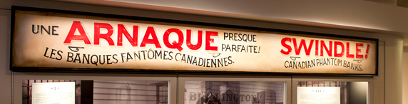

  3. How should I be prepping the wooden sign that I'm repurposing? I was going to just sand it to give it a rough surface since I'm flooding it with black, nothing should bleed through.
Here's a photo of the wooden sign in it's current state:
Any help would be GREATLY appreciated. Thanks in advance!

  3. How should I be prepping the wooden sign that I'm repurposing? I was going to just sand it to give it a rough surface since I'm flooding it with black, nothing should bleed through. Sand, prime any bare spots and paint. Just a regular coat or two, not "flooding".
