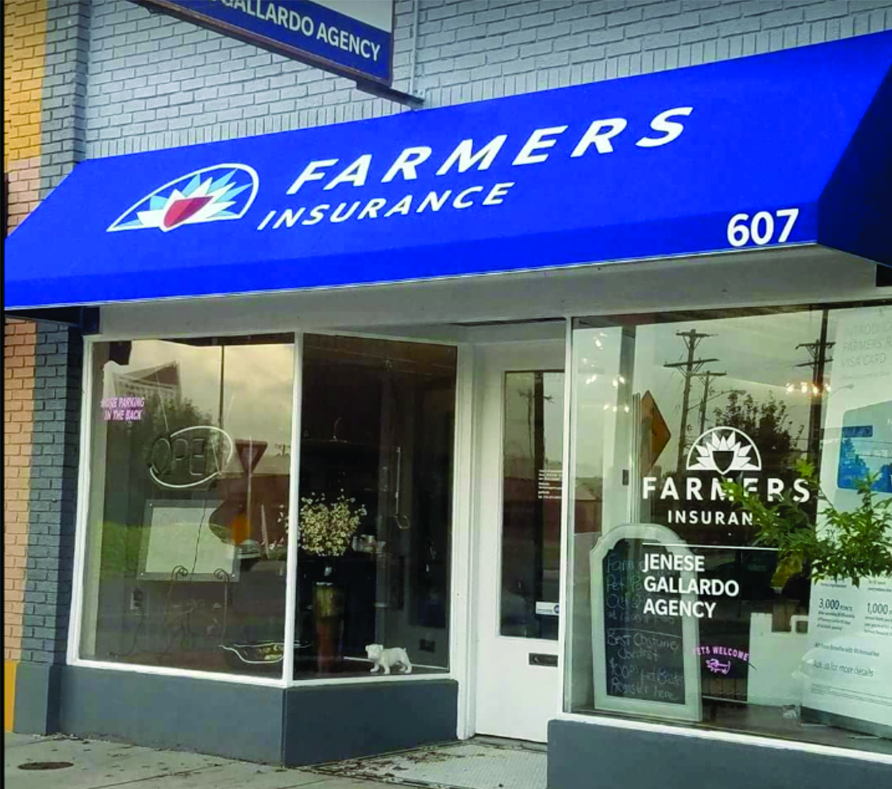

I painted this awning a couple years ago, this one is all 1-Shot enamels. Since it has multiple colors this one took a few days to paint everything.
