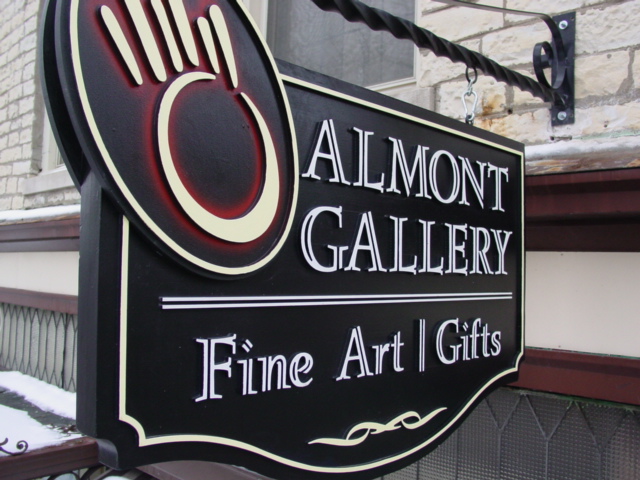

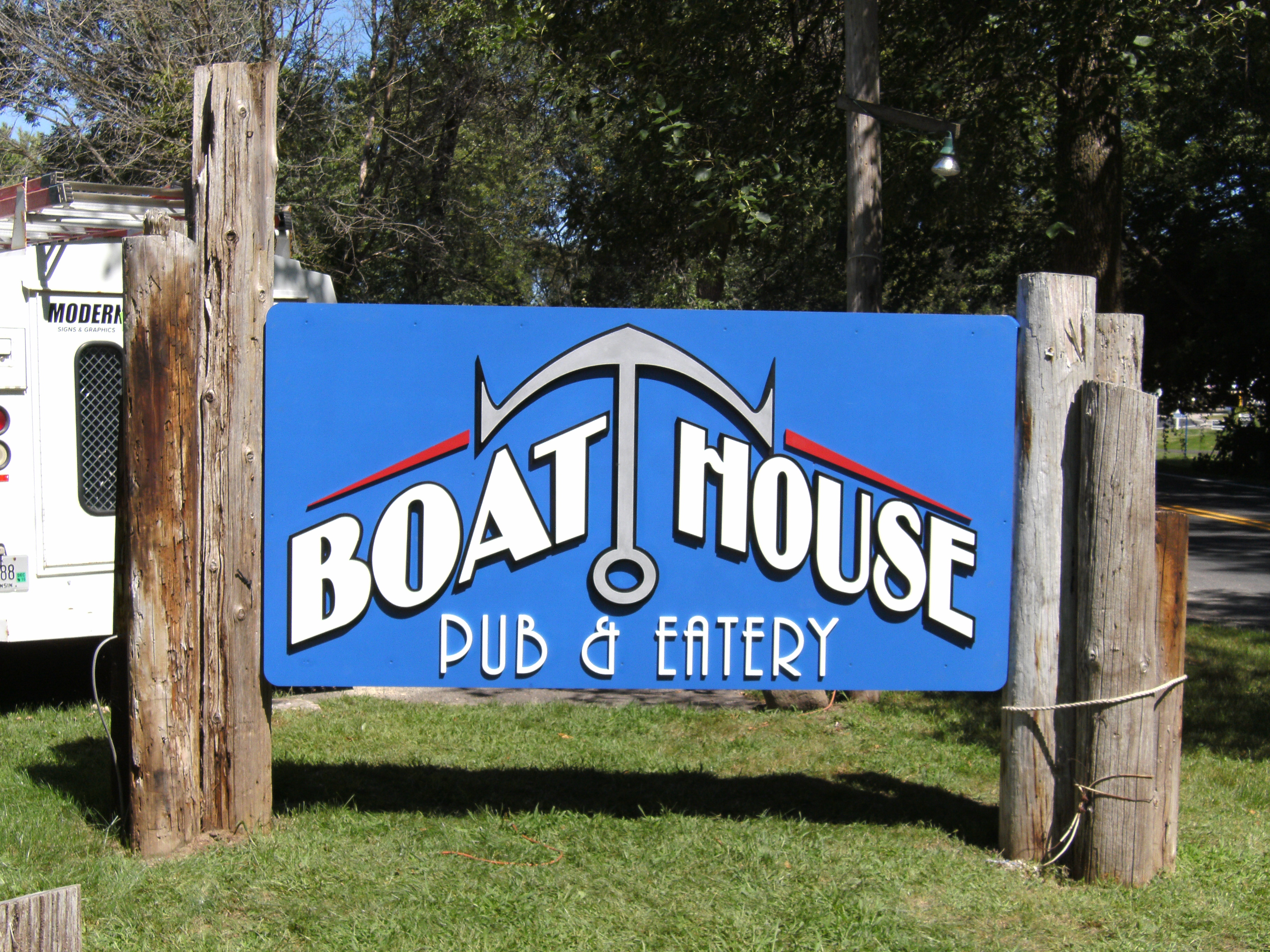

Modern Ink Signs
I use a primer/sealer and then paint with your latex paint of choice.
