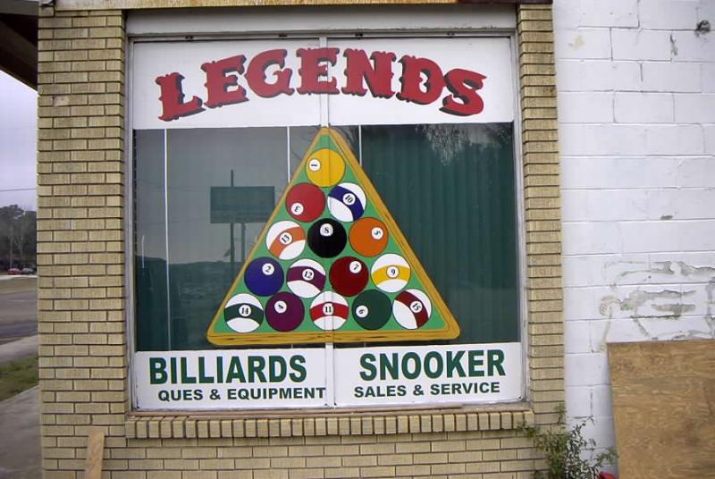

this is all 1-SHOT except for the green words on the bottom.........was done in 2000..........and is still on one of the 2 windows i did........
