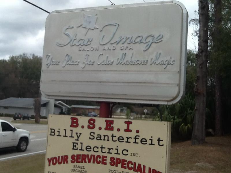

Here is a photo of the old sign. I haven't done one like this.... it's very old.
I'm thinking that only pan face will go back into it anyway.

If it's only 7" thick a flat face will show the lights.
A lot of municipalities won't approve those old cans if it has exposed wires inside FYI
At 5' x 8' you need the strength of the pan face. Also, you need to keep your face more than 3-1/2" from a lamp source or you'll experience hot spots..... and the customer might be a little upset with that feature.
