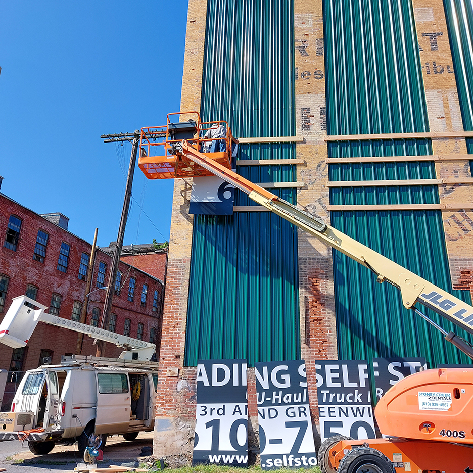

We recently did a 12' x 40' sign. Took a long day to put it all up, but we got the frame up and really only had 7 seems to deal with, but also fastened two rows in the middle, plus top and bottom.
