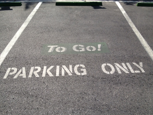

So I have a customer who is a painter and he is asking about custom reusable stencils for painting parking spots. I was wondering if there are any recommendations for a supplier or material we maybe able to cut on our Graphtec 8000-130

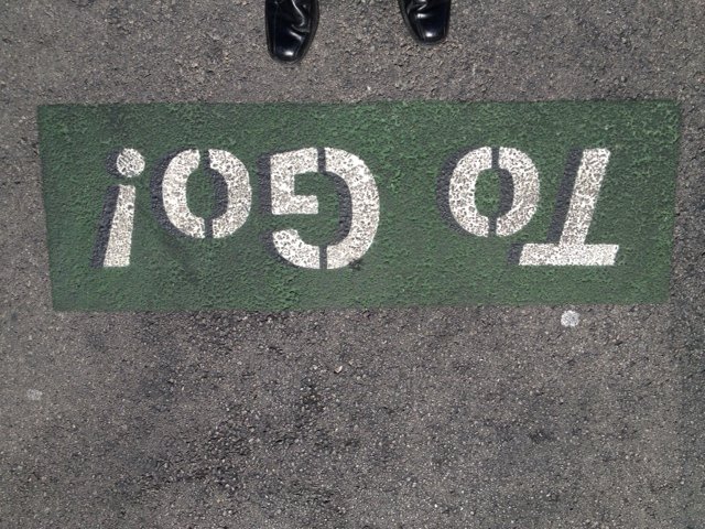

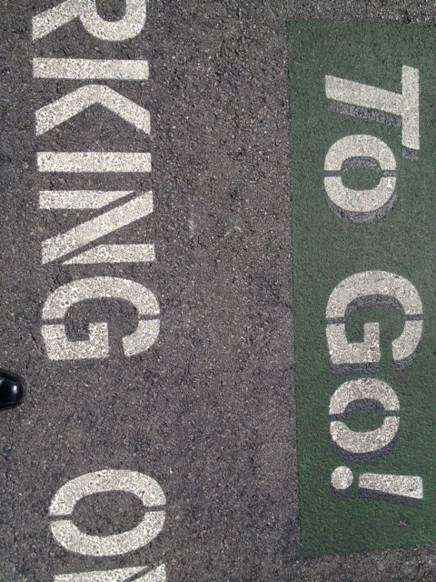

Thanks guys I will look into all those. My customer just got the painting contract for all the local locations but is looking for us to make a custom stencil to just lay over the attached and refresh the paint. He wants reusable because there are 8 locations with 2-6 per and it will get expensive to keep throwing them away.
We have used sign mart before never thought of them I will check with them today.
