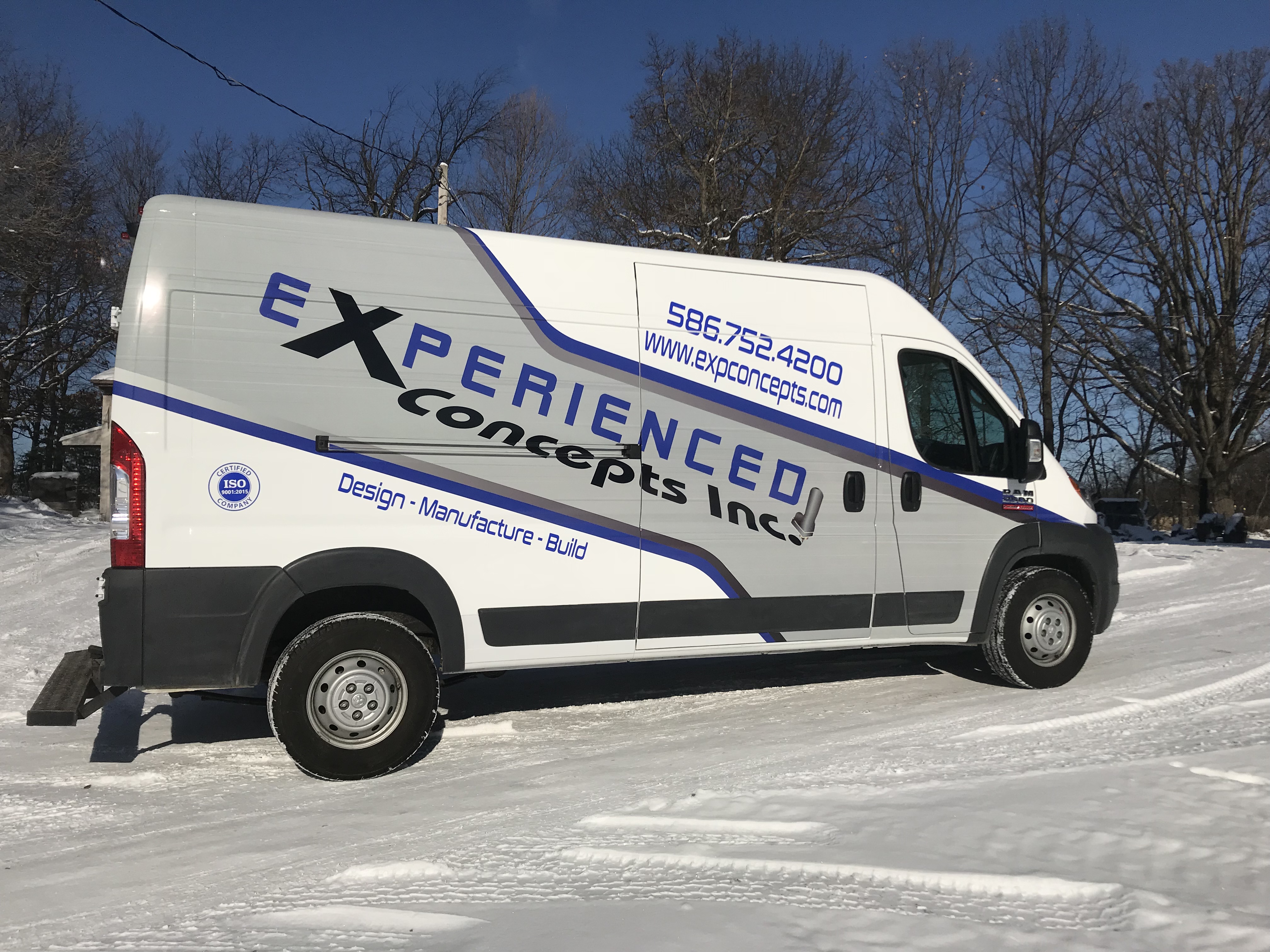

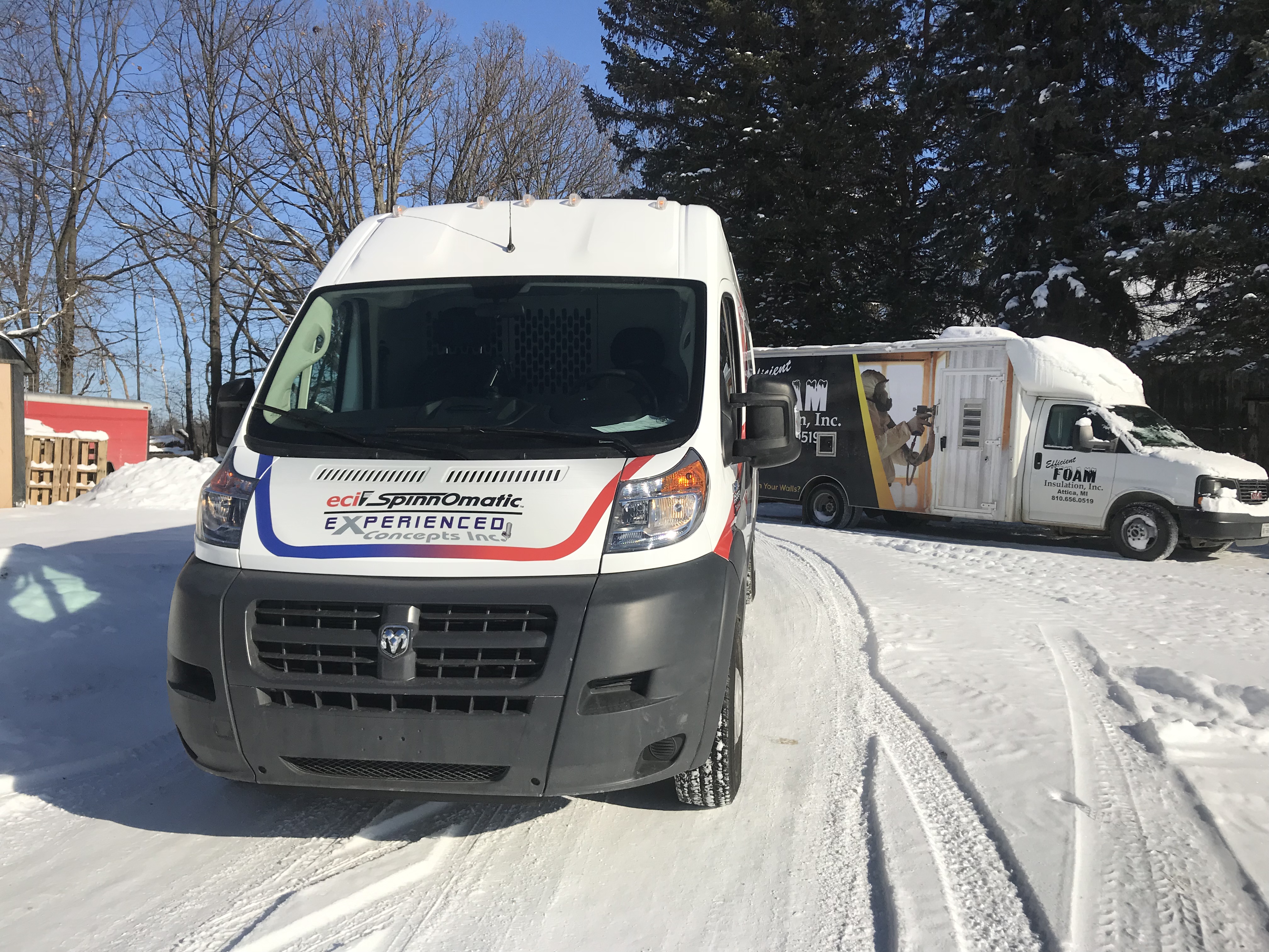

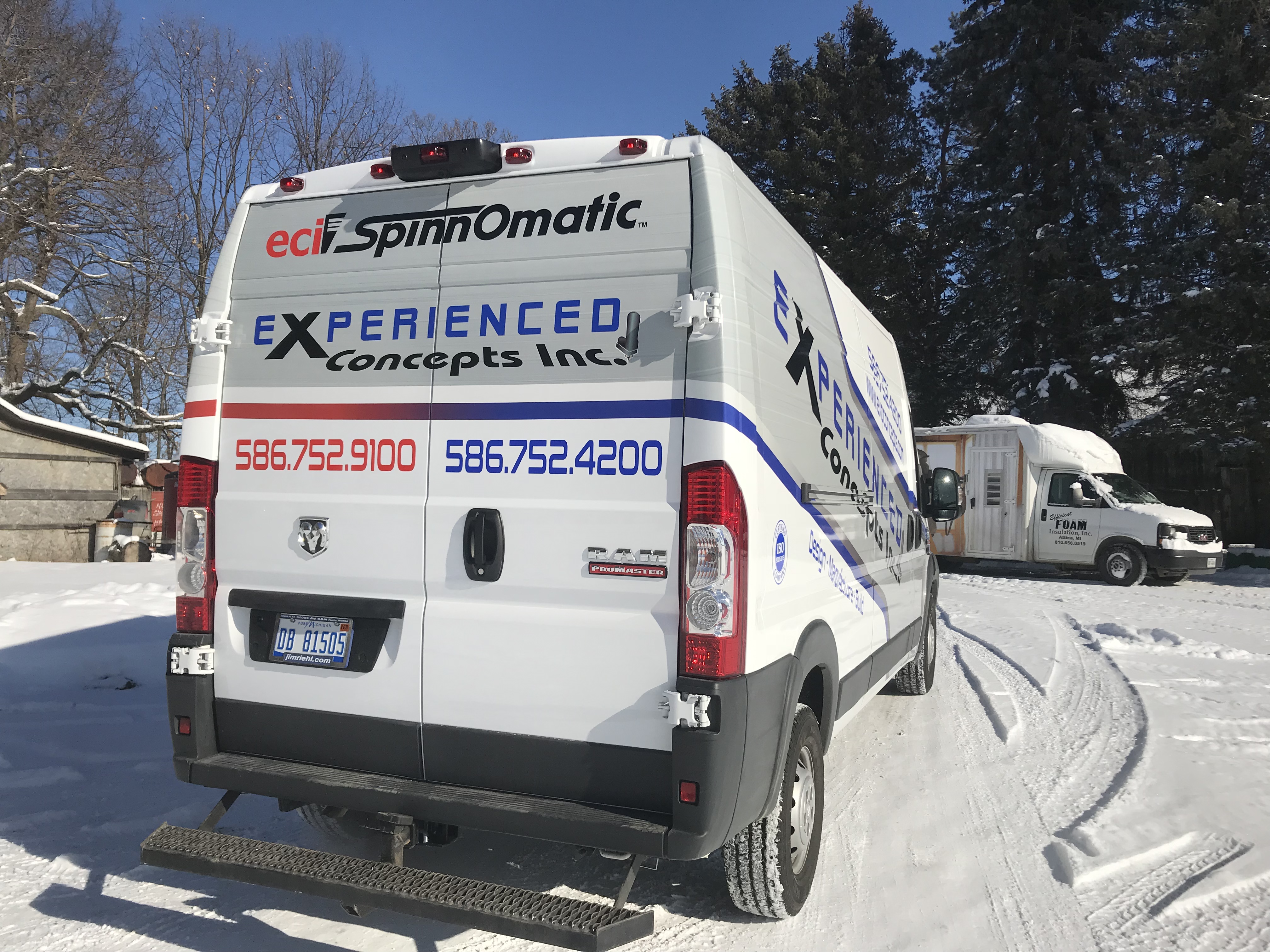

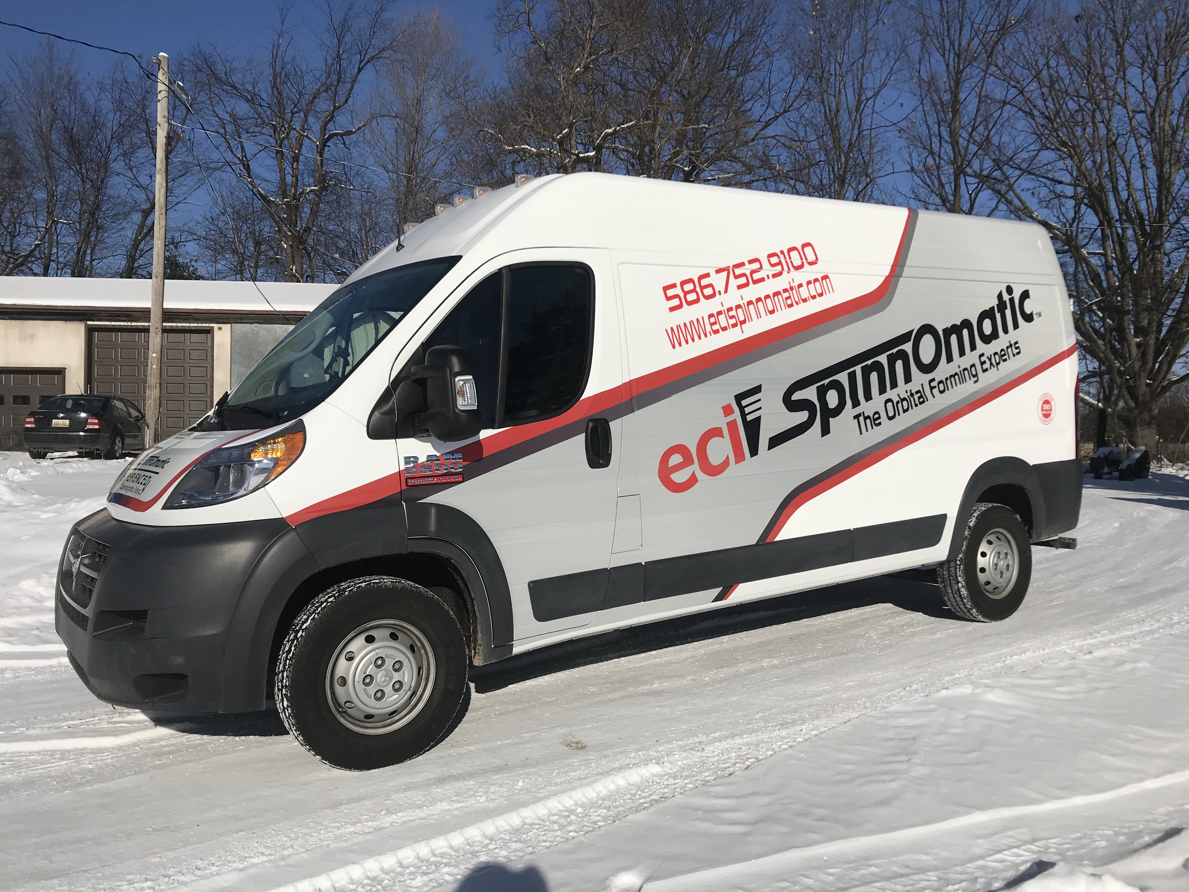

Thank you guys for all the help! We ended up going with a a horizontal seam. It was definitely interesting and a lot easier then I had expected! Again, thanks for the help!

WB
That looks nothing like the original mock up but maybe I'm missing something.
You wrapped the sliding rail for the door does that part not get touched by the slider?
Darion Judd
The original mock up was sent to us by the client as an “idea” and it was made for a Mercedes. We had to come up with a design for the promaster.
