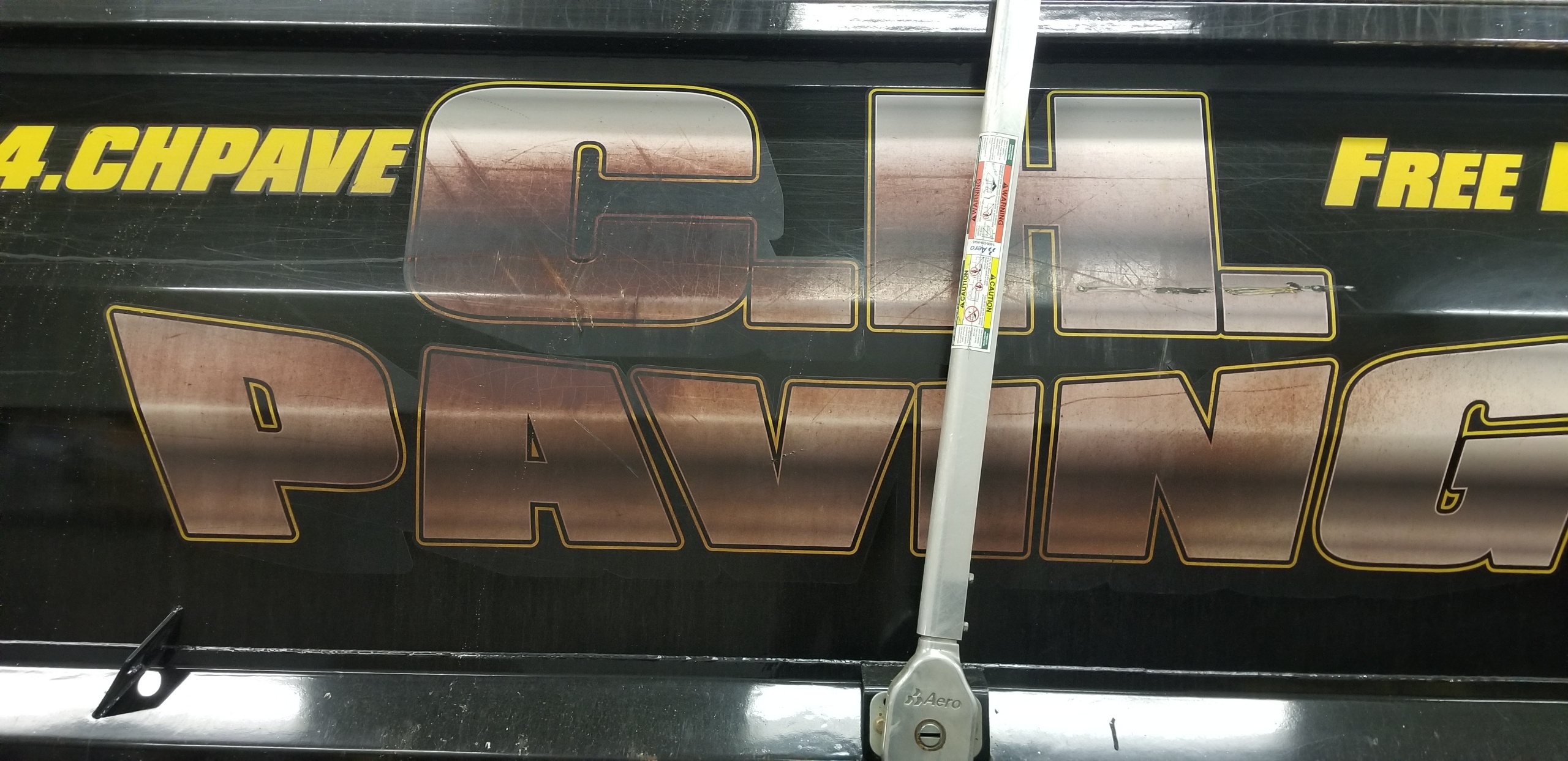

Paving dump truck printed vinyl failing
brycesteiner
You'll have to charge a premium for this and just let them know that it's not warranted with that kind of heat. I really think that 2 years isn't that bad considering what it's going through.
Another responder suggested paint. I tend to agree or just have to understand that it's literally melting it.

In the 2018 Fellers catalog they are showing calipers being wrapped using 680CR reflective.
It is a 7 mil film which makes it 3.5 times thicker than IJ180, that might insulate the laminate to some degree? Pretty obvious that extreme heat is the culprit, just look at the top of the "C" and "H" in both photos are perfectly fine.

Maybe the truck is making too many fast right turns causing the hot asphalt to burn one side up quicker

Why charge a premium and then not warranty it? Its an easy install with standard materials. That makes zero sense.
mpn
IMHO that's a sunburned graphic. Have a box van in my yard now that is parked in the same spot everyday. Graphic is oracal cast with matching cast laminate. Starts to burn around the 1.5 year mark like clockwork. Replacement is 2:1 versus the other side. Also noticed when the trucks are parked in a row it seems to accelerate the issue, maybe more reflection/heat caused by the trucks being stacked together.

Probably right. We painted a crane about 2 years ago with a middle of the road polyurethane, same as we use on everything. Its parked (and sits half the time) in the same spot everyday. The southern facing side is faded badly and we dont have this problem with other things we have painted.

I agree with the laminate UV burn as commonly seen with Oracals calendered lam films (210). I have had good luck with Oracals cast lam films (290) as long as it's on a vertical surface, put it on the hood of a vehicle and it goes to shit in a couple years. So this is now occurring with latex inks, so much for the solvent outgassing claims from the media manufacturers.
Also think the 350 degree asphalt is a contributing factor just like engine heat on vehicle hoods.

Looks like Heat from the Load You can actually see where the bed was loaded ? the Round Mound Burnt int the graphic ?

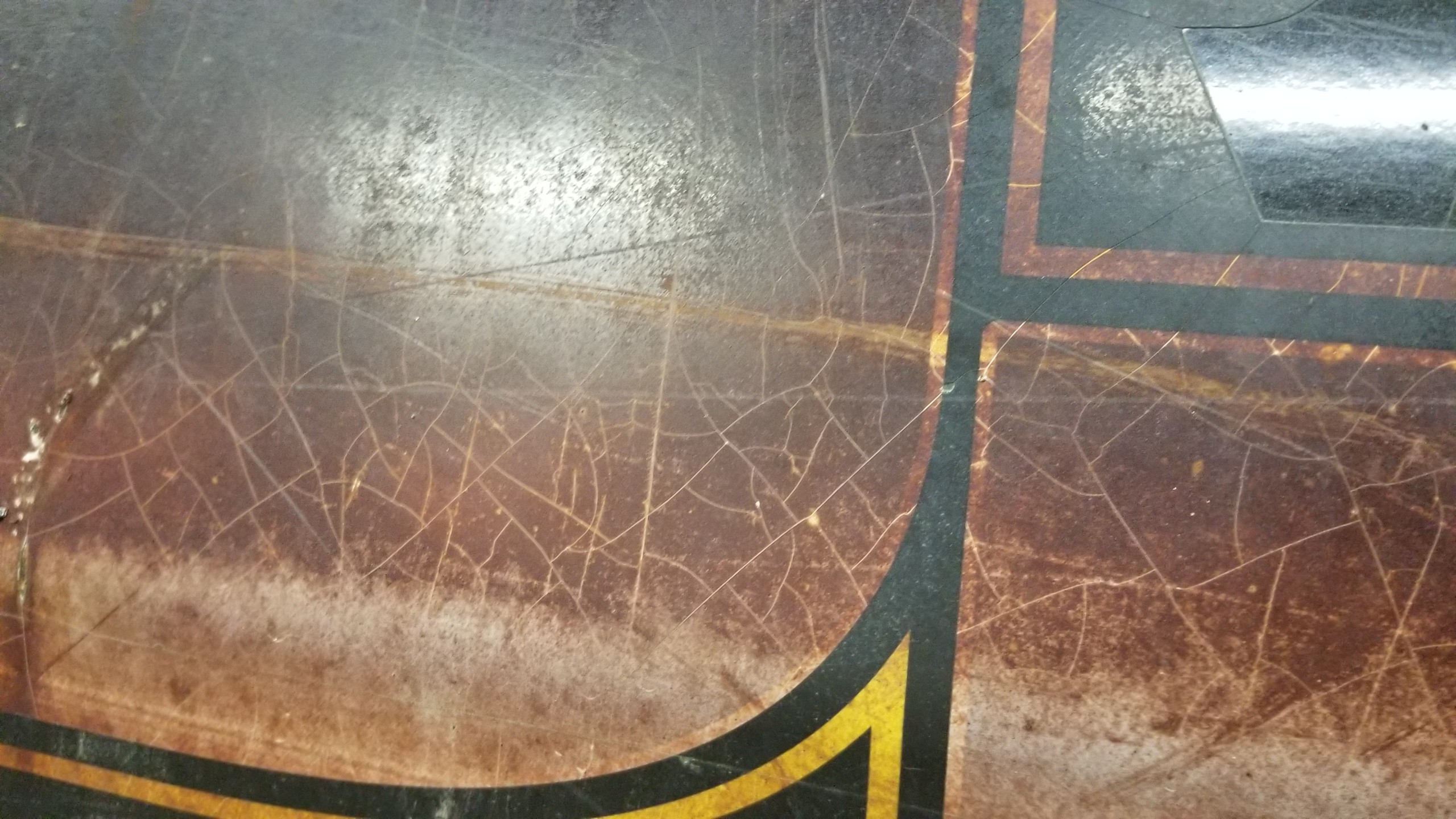

Wanted to give an update on this, I recently had another paver come in with this problem. While cleaning the vinyl off I accidentally separated the laminate from the print, and to my amazement found that it was not the vinyl that was discolored but the laminate was the culprit. The print is absolutely perfect under there. The laminate has failed. Check out the pictures. This is ij180 with 8518

Most companies that haul asphalt use diesel to clean the bed maybe that deteriorated the lam? Just a thought.
Sent from my iPhone using Tapatalk
Most companies hand spray diesel on the inside of the body before being loaded. Usually from one side. May be a contributing factor over time on the side the spray from?????
Notnormal
We used to own a dumptruck company and yes, diesel gets sprayed all over the truck to get tar off plus the load must stay over 200 degrees at all times and very easy over 300 at time of loading. there should be a small hole drilled in the side somewhere where the guys at the job site stick a thermometer in the hole to check the temp. under 200 and the load is rejected. seems to me like the laminate is not holding up to the heat and diesel combo.
