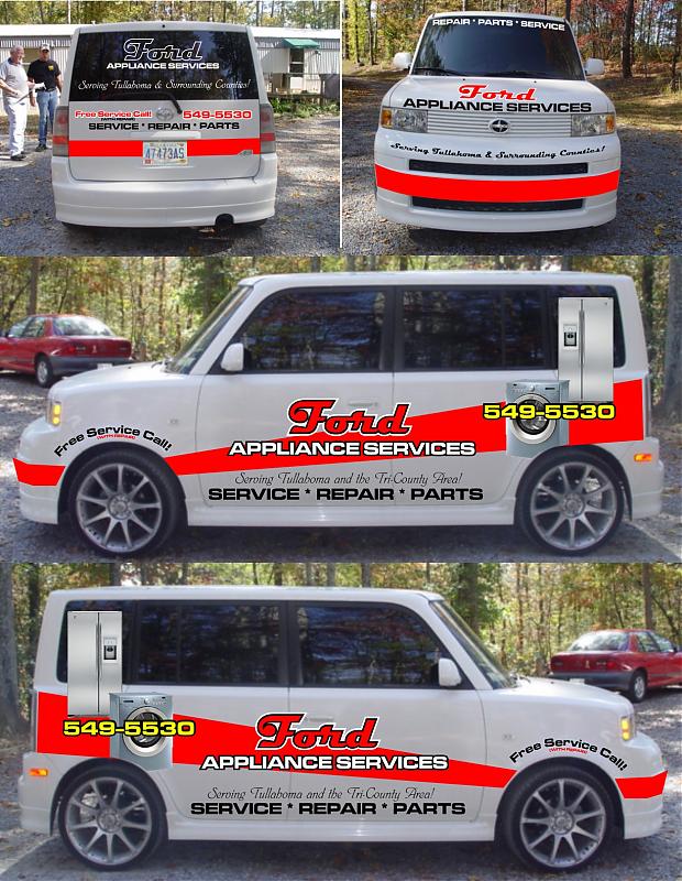

Thanks for the response. Here is a basic layout for the vehicle graphics that I am proposing. The customer doesn't want any vinyl to go over the molding around the windows, but, the rear vent window has no moulding.
