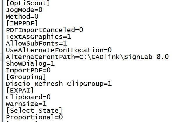

The ini file is called Cadlink.ini within your Signlab8 folder. It stores all your preferences etc.
You can edit them and re-save them if necessary. Make a backup/rename of the original first and edit the copy.
Look through the text and compare the (IMPPDF) options to mine attached.
If something is different, change it and see if it fixes your import problem.
