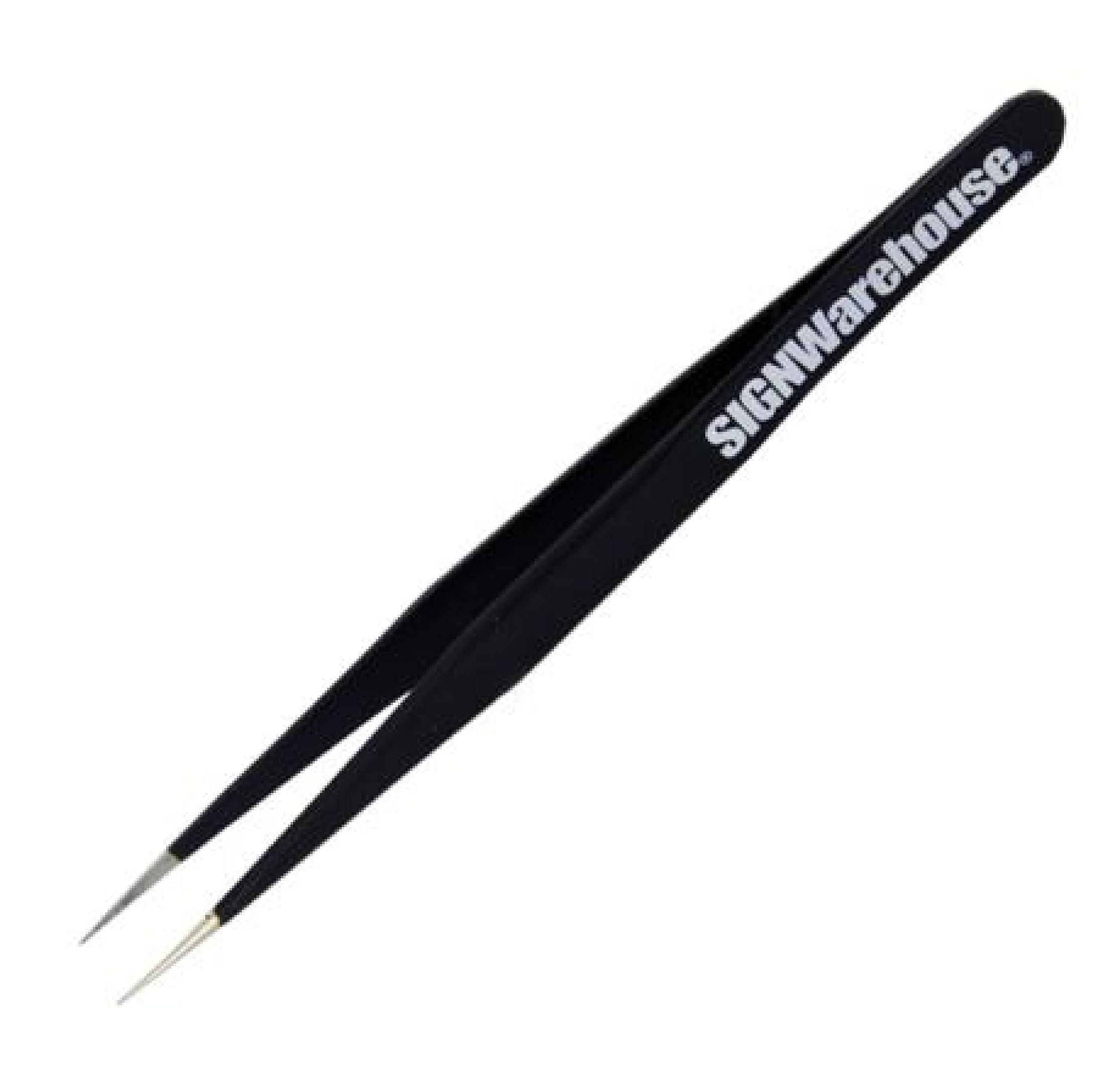

Get yourself some of these (photo attached). Grab a corner and presto. I sometimes make sure the tape is rolled on with some pressure from a roller applicator.
they are "weeding tweezers"
We take an old tiny flat head and file it down so it's basically just a pick.
