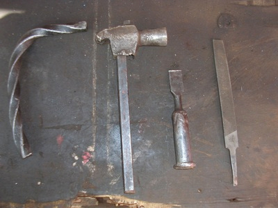

Now you can go buy that tool collection you've been eying up...............

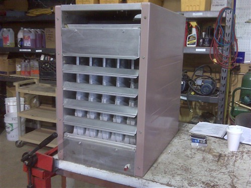

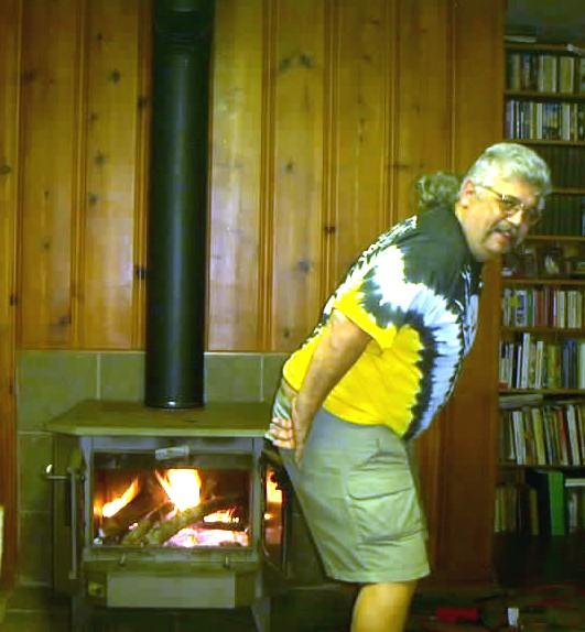

i dont have a pellet stove, but i got this in the 2000 sq ft house. in northwest fl we sometimes see night temps in the low 20's, and this will heat the whole house with a few logs. in the shop/garage iam putting this REZNOR 30k, and converting it to LP since running a natural gas line is such a pita nowadays.need to add that for the shop, i will put a outside cold air duct................on the bottom of it. what this does is the air supply for the flame, comes from the air .......OUTSIDE of the shop & if you have any paint or chemical fumes in the shop, the flame doesn't get them to burn and foul the heated air with an ordure. it also has a vent like a chimney for the burnt propane.
