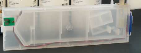

Another thing I ran into years back when we had our JV3..... On that machine the bulk system we used had dummy chips on the sides of the cartridge tanks that extended out to the end of the cartridges. On the end of the cartridge was a small slot where you were supposed to plug the chips in. It was really designed to use disposable chips that would come with the ink whenever you bought more ink. When we used them that way they would not work half the time. The only thing I could think was either a poor connection between the dummy chip and the slot or the bit on the end of the cartridge that you plug the chip into or the extra foot or so of distance was making them not read right. I took the extender bit off and mounted the chips directly to the cartridges and they worked perfectly fine then. That's when I got our first set of permanent chips...

So you are running bulk. Are the chips you are using get mounted directly to the sides of the cartridges like where the chips are on a normal cartridge or do they stick into the end of the bulk cartridge or something? This is the sort that was giving me fits years back. The dummy chip on the cartridge has wires that run to the blue connector on the end of the cartridge and you stick the chips you get into the blue connector. I even checked the continuity with a multimeter from the blue connector to the dummy chip and it was 100% but the chips simply did not like working through that. As soon as I removed the dummy chip on the side of that (and cut the wire off) then screwed the permanent chip to the side of the cartridge it never gave me a single problem again. Just have to reboot the printer to reset the ink level. Of course this method is not very fun with disposable chips since you have to remove the cartridge and physically scange the chip on the side of it every time.
Also - NEVER install a cartridge without a chip screwed onto that spot on the side (dummy chip, good chip, whatever). With no chip there the switch inside the slots will get jammed in the recess where the chip is supposed to be and potentially damage something. I know this from experience (the hard way).

OK this is what I did..... I purchased 8 one time chips for $80.00 and I took off all the current chips and put these on. Started up the printer BOOM!!! ready to go. So now one can say that these permanent chips he sent me are crap!!! I now have the option to use up what ink I have in the bottles with these one time chips and then convert over to the 440 cartridges or wait for a new shipment of permanent chips.
On a side note, when this issue started about 4 months ago I remember that my supplier sent me 8 new permanent chips... 4 of them were on a burgundy board and 4 were on a green board. From what I have learnt up till now permanent chips are burgundy and one time are green.... this is probably why this whole mess happened to begin with....agree?
