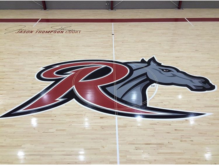

we work with a flooring company who has done everything from elementary school gyms to a few different NBA courts.
the graphics are painted using stencils, no decals.
This is a recent job we did the stencils for.. the center court logo alone was 28 feet wide and about 15 feet tall, and its got 7 colors! We have a few upcoming jobs where its going to be about 2K linear feet of paintmask because the graphics are huge and colorful.
If you have any other questions, feel free to ask me, we're really good at making big, multicolored stencils. i can give you a few pointers on how to set up the files.
