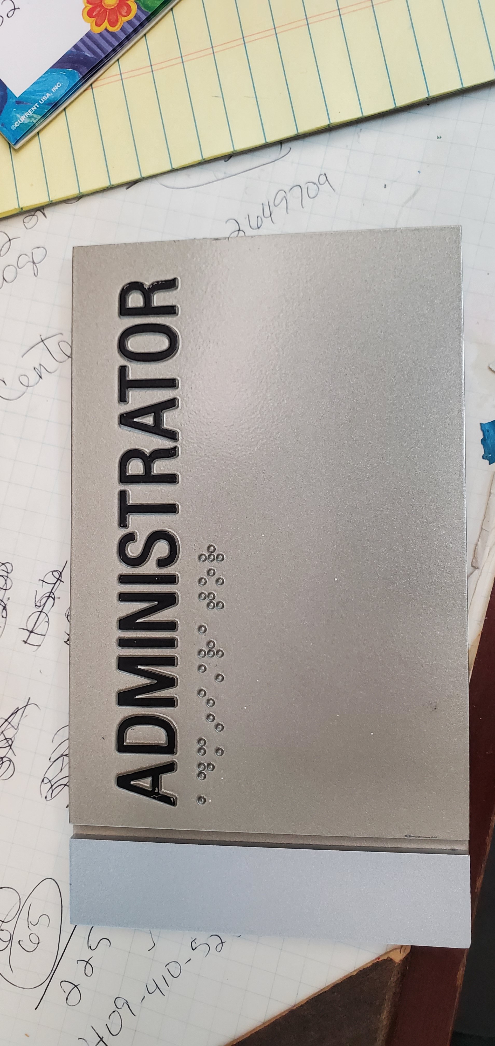

Anyone know where I can get these signs quick? Who do you use to make these?

Looks to be a photopolymer. Drawing a blank on who does them, but there are a number of suppliers. I think one of the merchant members here does it.

not sure you're gonna get a quick turn around. most custom braille work is at least two to three weeks out. at least that's why my local vendor is always at.

Actually I'd say that in particular is thermoformed. We do these with an engraver and rowmark materials, it's a simple enough process, but the braille is an expensive game to get in on as far as software is concerned.
Howard industries has pretty fast turn around if I recall correctly.
I agree about that being a thermoformed faceplate. We produce 99% our own ADA work w/ either Rowmark or photopolymer but we've had to provide thermo signs for a couple of projects and we procured them from Graphic Components (www.graphiccomponents.com) out of Greensboro, NC.
