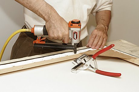

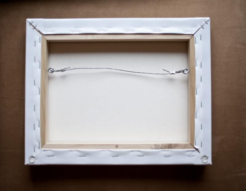

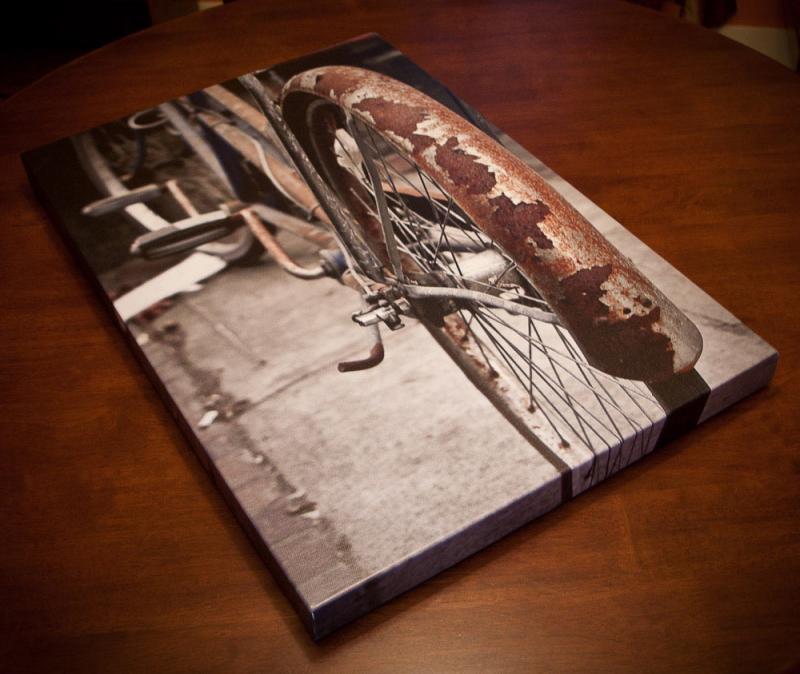

Gallery wraps
Coming from a photographic background and having worked the industry for a long time, I think prints like thode you are making would be considered wall art, and I find these types of prints sell better if printed on a canvas and mounted as a gallery wrap on stretcher bars.
Gallery wraps come in a few different sizes from 1" to 2-1/2" deep, I make all mine own stretcher bars and I make them 1-1/4" deep. On of my best sellers is a set of 5 prints in a cluster, a square in the center with 2 horizontal, and 2 vertical prints that surround the square.
Of course like any ink-jet print, you need to protect the surface of the prints, and I like to use a liquid satin product by Lexjet which can be either rolled-on with a foam roller or the preferred method of spraying with HVLP spray gun.
I just think display prints (wall art) look better on the textured canvas surface over the calendered vinyl, see example below.

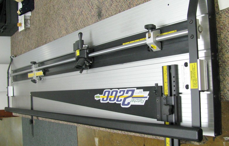

I just bought this Fletcher 2200 mat cutter yesterday (used) for $500.00 from a retiring artist; they normally go for about $2000.00. So this really opens up my framing options. It'll cut up to 48" mat. I've already filled a few 8x10 frames that were kicking around the house, and used my desktop Canon printer on photo paper. Sweet!
A proper 24" photo printer is looking mighty tempting. Please......someone stop me now! :Big Laugh
