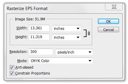

I believe you are trying to sneak into Photoshop from a bad direction. If you simply OPEN an Illustrator AI or EPS file, you get this dialog box. In that box, you can change the size of the vector graphic to any size you want, and you can change the resolution to any you want. Of course, the practical size of the file will depend on the power of your computer and the amount of RAM you can access. As you can see in this example, a relatively small graphic at 300 dpi is just shy of 52 megs when it opens and can swell tremendously as you add more layers and effects while in Photoshop. If you managed to make a file at 500-600(+) megs, your system could slow down as it starts attempting to write to your scratch disk.
And, to be maybe more accurate, you need to find out the optimum LPI output your printer can handle. Then, on average, your DPI should end up at twice that amount at full size. Many glossy magazines are printed at 133 LPI, so the DPI for any image on the pages should be 266. A Gerber Edge, for example, works fine at roughly 75 LPI, so 150 DPI images print well at full size. Due to the distance many signs are actually viewed, they can actually be more pixelated and still look okay. Get close, and they can be quite rough.
Copying and pasting images from other applications into and out of Photoshop won't give you the same options as using the OPEN and SAVE commands.

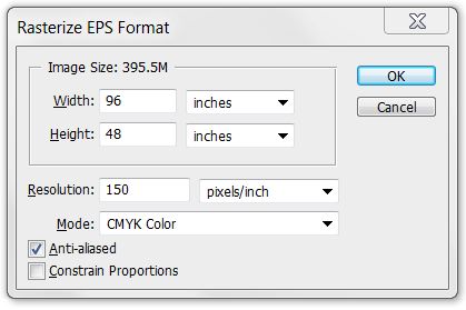

Here's a screen grab of the Open dialog box for a 48" x 96" image at 150 dpi. The file is almost 400 megs.
