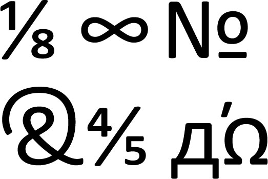

In Illustrator there is a tab called "glyphs". In some OTF Opentype fonts there are in some cases over 100 characters designed into a font that you CANNOT access through alt keys or the character map

I had a job the other day where I had to type out some letters in Russian. The OTF Arial Bold font has the built in Russian characters. Attached are some of the many odds/ends that can be found in the font glyphs
I think Arial has several hundred extra characters

And Bickham script,"one of my favorites" has hundreds of alt. characters you would never know about without the glyph pallet
