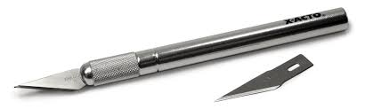

one last thought is maybe its the wrong type of phototex for your printer? (waterbased vs solvent)
Ahh...hadn't thought of that. They may indeed be scraping off ink when they cut, if they're running solvent on a latex material.
Photo Tex
So I am thinking also it is the knife scrapping the ink off (although I have not really heard of this over the years) so we recommend a sharp pointed single blade knife also. Use something against the knife to guide it and not freelance the knife. Send me your e-mail and I will send you a video walterjr@phototexgroup.com of installers doing this method.
Also , The Photo Tex will not shrink so yes you can butt the material or we now offer a OPAQUE block-out so if you do overlap the seem is way harder to detect.

So here is the video and you can see no white line after cutting so please anyone e-mail me direct walterjr@phototexgroup if you have any questions and we can work together.
http://www.youtube.com/watch?v=PUHj-xkNHjQ OVERLAP - 5:50 mark – he cuts through both overlap layers (note he cuts in the middle of the overlap, so if it is 1” overlap he cuts ½”) – splitting the overlap difference. You can cut just through the top layer only (as to not damage a wall) Cutting through both layers you have to make sure your cutting in the MIDDLE of the overlap. Cutting just the top you can fudge over to make less of a seem (more like 1/4” down from 1”)
