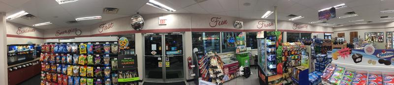

Phototex has been amazing for me. Probably used it 6-7 years or so now. We have used both the standard stuff, and they now have a high tack that I've used (installs a little harder because it grabs more, but still totally repositionable) and love it. We cut it too, just cut slow. Prints real nice. Here's a convenience store we did with the high tack a couple months ago.
