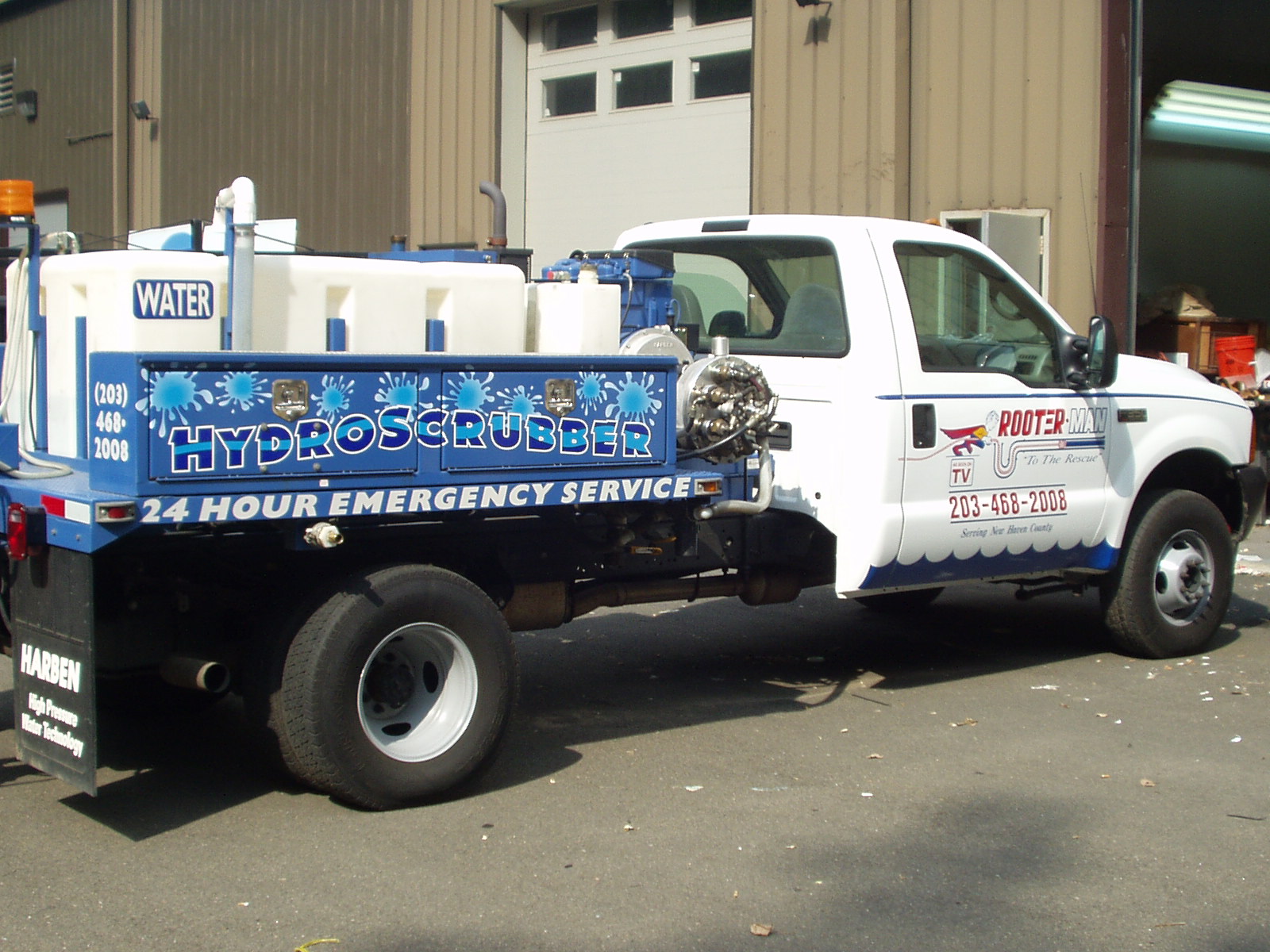

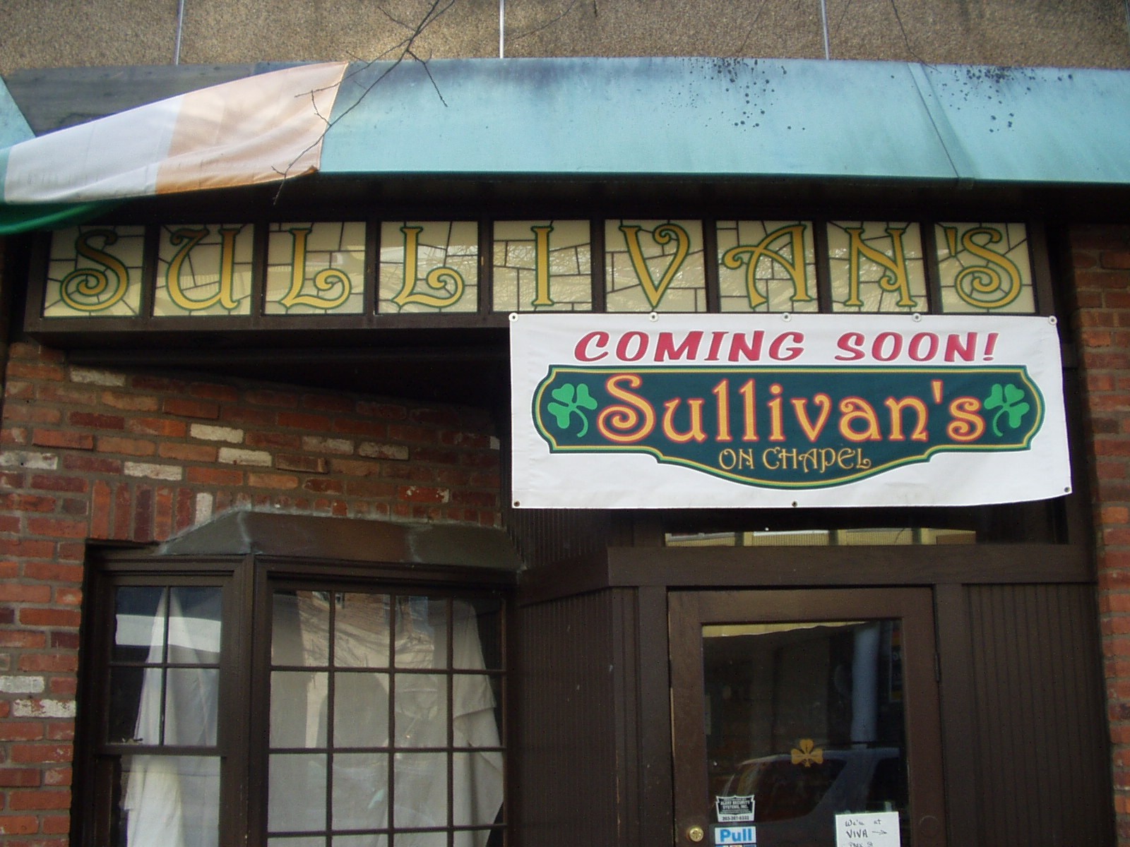

You didn't answer my question. But here's my take. The Edge is an awesome machine within it's limitations. the biggest limit being the 11.8" limit, but tiling is pretty accurate and before laminated wide format prints took over the market we would use it for some pretty big jobs. For contour cut spot color vehicle lettering and signs it is great. It's a;so pretty good at fades.
We have an Edge 2 and for 4 color work it can be hit and miss. It's also perfect for small decals. the availability of lots of special materials and foils is also a great asset.
As for the Summa DC4, I was disappointed in ours. We never really got it going well. Banding issues popped up often. I know there are people out there who are using them very successfully but we aren't one of them. I attached a few pics of older jobs that were edge printed. The restaurant banner logo and the fake stained glass panels were on the edge. The truck multi color stuff was edge printed and contour cut.
