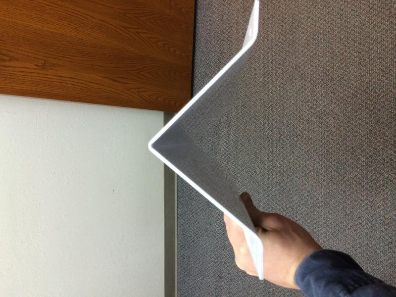

Does anyone have a supplier for 3-way plastic sign blanks? I see Dura Label sells them and Accuform signs has Printed ones under their projection brand. I also checked bestblanks but came up short.
Thanks,
Don
CreatedDesigns
Ha! It's is just a sign that is bent in 3 spots to mount flat to a wall and protrude off the wall in a triangle shape. And is able to be seen straight on and left to right.

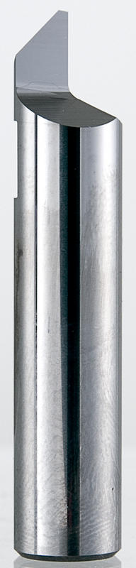

Ahhh that makes sense. We have bought them from accuform before. I think I also made some out of Dibond using our fletcher stand up cutter with the v-groove bit
Do you have a picture or something of this bit ?? I never knew it existed. We have a FSC. Gonna do some research, but that looks like a handy little tool.
SebastienL
Hey Gino,
I use this bit on aluminum composite. Can't remember where we got them, either Onsrud or Belin. I have a few of them but there's no marking on them. It leaves a flat bottom in the groove. Makes it a lot easier to bend at 90 deg.
