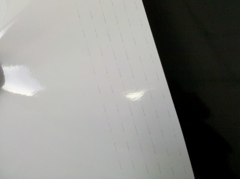

Im getting hairline streaks of color over unprinted areas. Im in a tight squeeze as I have a wrap due by monday. Printer was up and running fine this morning until this job an hr ago. I have a vp-540.
Thanks in Advance
82R909
There it is on the original post... Now on some of the unprinted area there are all 4 colors streaking... on this picutre it is only showing the black streaking. Thanks again
82R909
fluff as in dirt/dust/strands?.... If thats the case I have done cleanings and clean it myself so at this point nope. I will keep checking after some test prints
noregrets
Move the head out to the maintenance position and examine it with a torch and just make sure it is free from any debris
82R909
okay, i actually did a cleaning and a firmware upgrade, and it seems to be wrking again. I have no idea whats up, but ill keep that in mind for the next time. Thanks for the quick feedback
