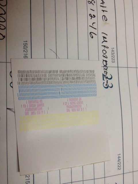

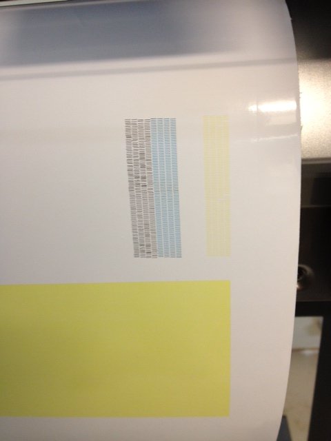

Well today my magenta stoped printing in my SP-300V. I had Solaris ink and went back to ecosol max and still doing it. Tried sucking some of the ink through the lines as per a thread I found when searching the forum, to no avail. Any ideas? Tried solvent on the caps. Didn't work. First pic if from current test cut and second pic is from yesterdays. Thanks alot in advance.

"inks look empty" is an indication the manifold "tip" is broken. Probably occurred when you changed the dampers and wipers. Your initial pictures reveal a more serious/expensive problem; BAD printhead. How long have you owned the SP300V? New or Used? What about basic maintenance of the SP300V?
