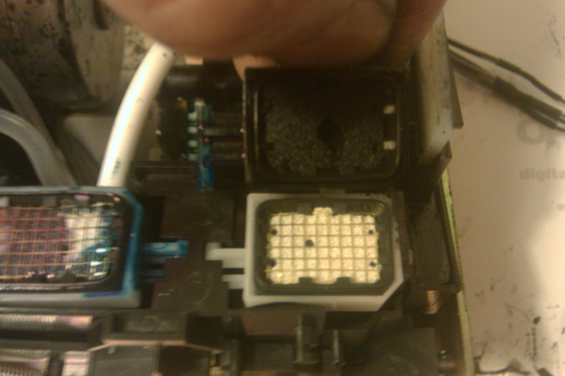

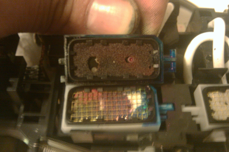

dj_elite
I know I know. Im just fed up. Like I said it has been problem after problem for the past 2 months. Now I just installed a new print head today any suggestions what I can do with it so it doesn't get clogged up on me? My printer is all apart capping station is out. Here are some pics of the caps Mutoh sent me. The ones in the top of the pictures are the old ones. Bottom are the new, notice how much smaller they are!

dj_elite
Between all the problems with the inks lately and now this with he capping station Im about to give up on this printer. Going to talk to signwarehouse today and then my lease company and figure out my options
