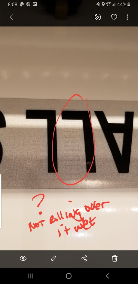

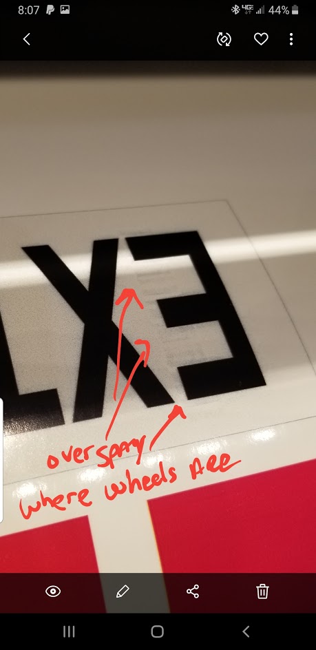

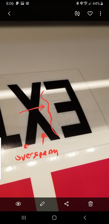

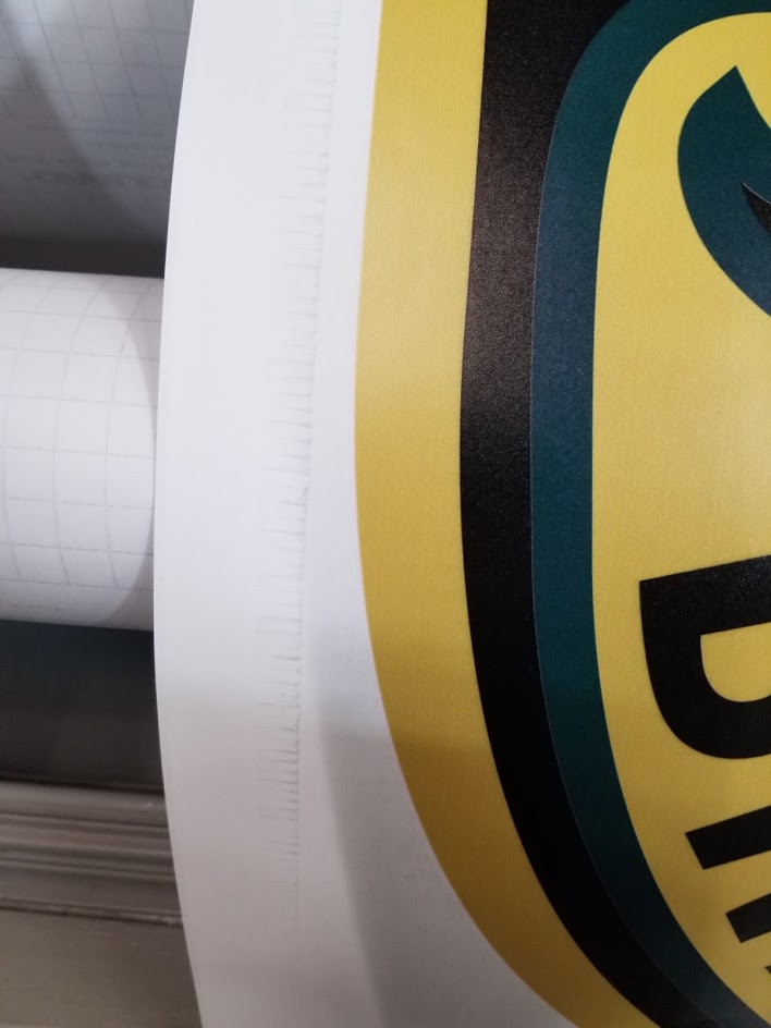

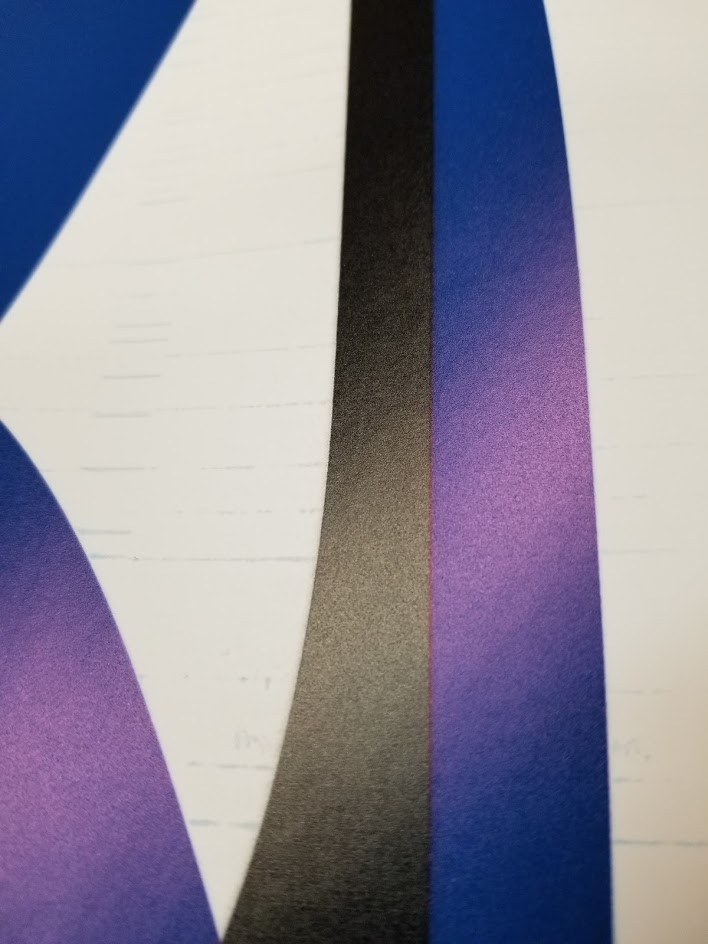

Hello Everyone,

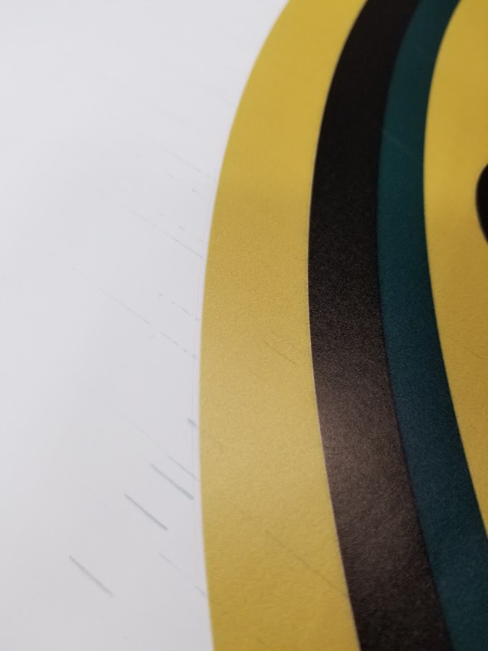

Having a recent issue past few weeks with my Roland XC-540 Pro III.
Heads are clean, Test print is great and all firing as they should.
It seems to be dragging Black across areas of my prints. Even where the wheels are? There are no marks or ink on the wheels. There are no threads or fuzz on the heads. I even placed static gaurd line across the back material I purchased a few years back.
I have the room regulated with heat as usual. I have been printing for over a decade and this is a first this year to me..... Puzzled.
See images.
Please help if you have a tip.
Thank you
Anthony

Change the material on the first printer to Orajet 3551 GRA gloss and it will leave faint tracks where the wheels grab the vinyl only??? This is crazy. I cleaned the wheels with alcohol and let it dry before I printed.
This is nuts...

It looks like the pinch wheels are charging the vinyl when they rest, which is attracting ink droplets to those spots.

"BUT" I had the heat just fixed Thursday after Christmas. I had been using an electric heater in the office now for 4 weeks while waiting for the baseboard boiler to be repaired. That electric dry heat is when it started, now that I think of it !!!
UPDATE:
I ran a new test at 50% speed and Bingo we look clean. I put a humidifier in the room now and have baseboard heat running again for past few days.
My guy just ran out to grab that hygrometer you asked about. So I will see shortly. Thank you.
