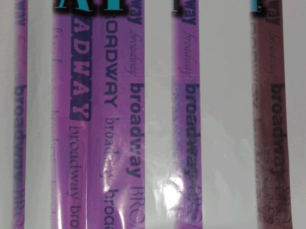

Big thank you for all who has helped, i have a problem the printer is printig terrible its a vj-1304 and im using ergosoft my problem is this see picture
if i turn the heater on in rip it is just warming up but not printing
gzolee
it does nozzle check
but it does not the palette and if i set the heaters to 45C it is hanging on warming up.
Thanks
gzolee
no errors at all
no error code it is just warming up very long and hanging on warming up i check the firmware version tommorow but i think it is the latest which could be used with bulk inks. thanks frimware 1.03 i think
randya
Do the heaters get hot?
If no, then could be heater issue or thermocouple issue.
Is heat uniform across the heaters, I believe that there are more than one thermocouple on the heaters, you could have a problem with one.
