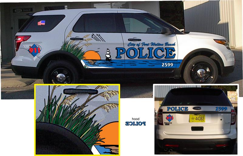

3M 5100 series here too. We do all county sheriff and 3 cities.
attachment.php
