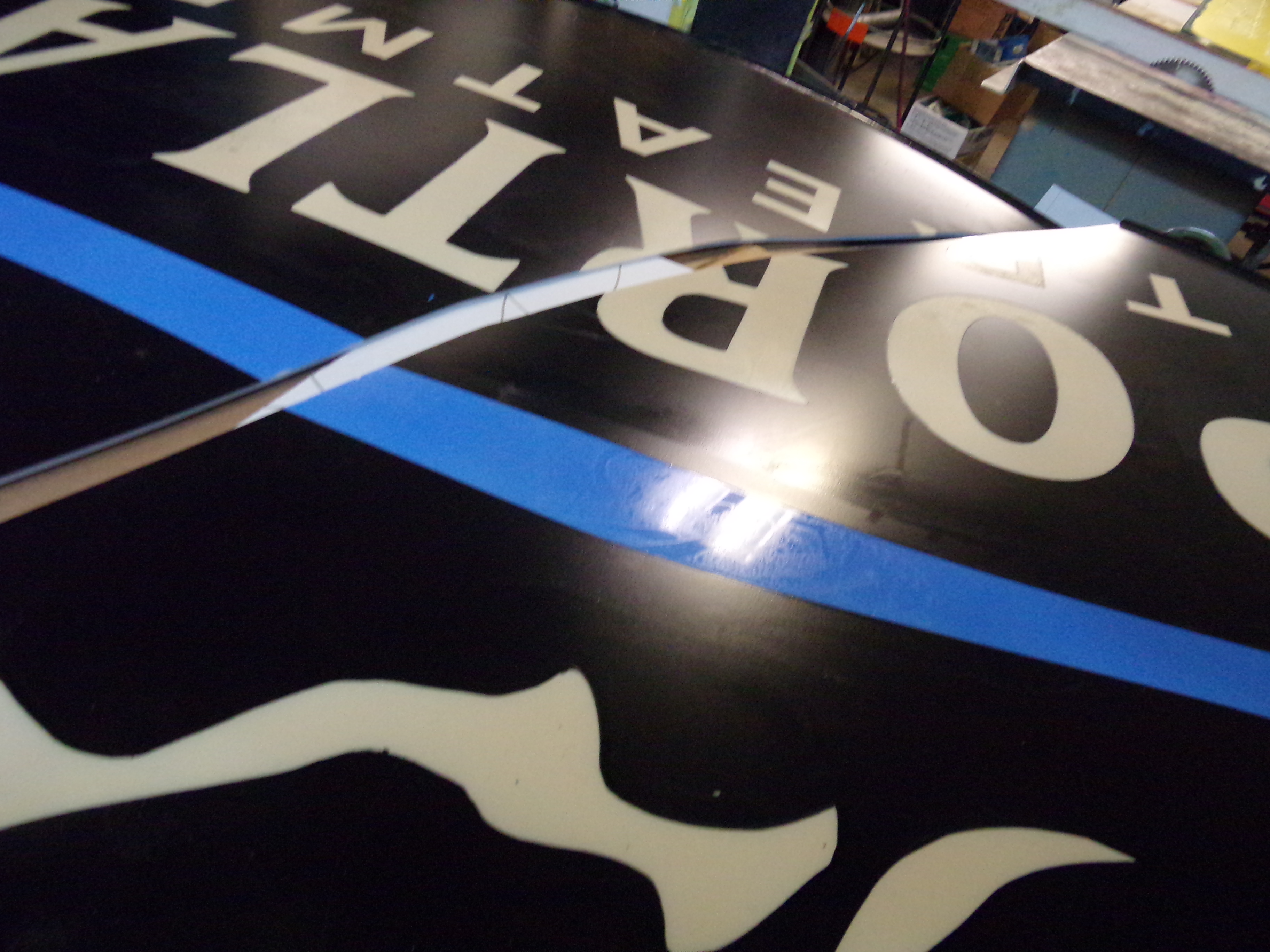

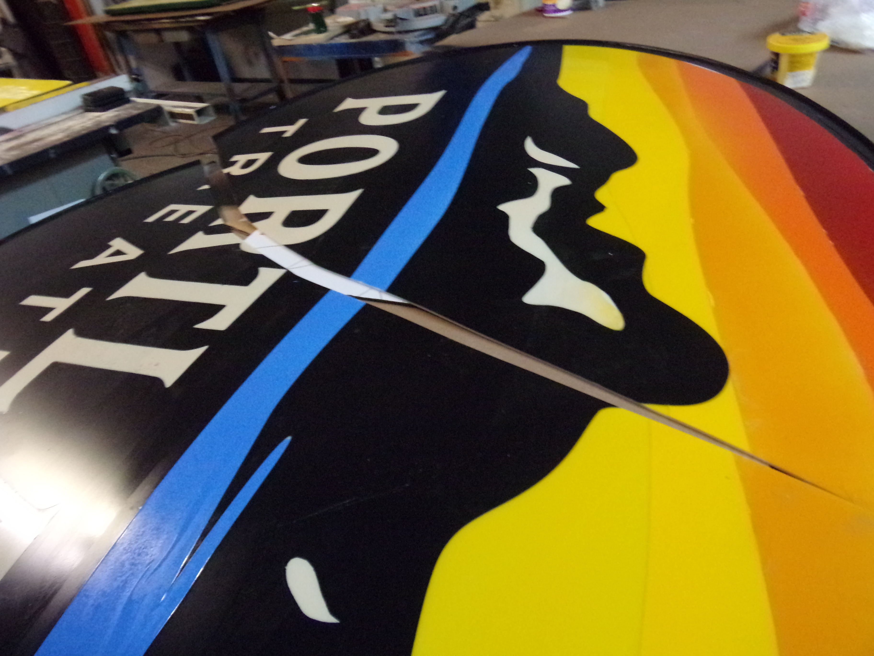

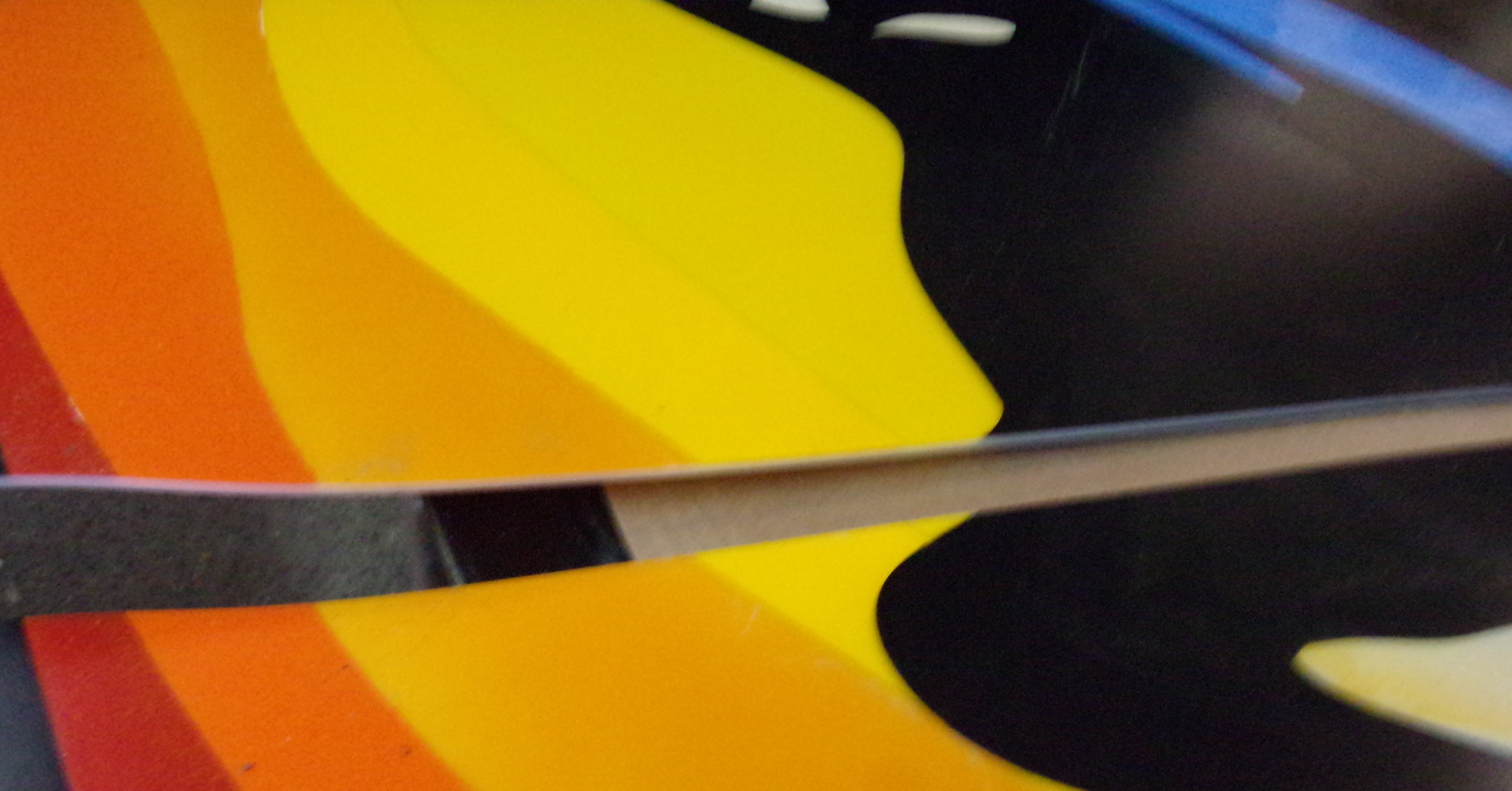

hey guys- just finished a polycarbonate oval out of 3/16" size 5' by 7' painted with lacryl and grip flex. trimmed with 2
' trimcap with channel bond. While inloading the face literally snapped in half. the masks we used were vinyl meaning we did not cut or score face. Am i wrong in thinking this should not have broken?
the plastic was a very small expense compared to the 6 color paint job. As usual my supply house is blowing me off. doesnt long pieces get rolled up? this was not nearly bent as it gets in the roll. feedback please......

that definitely seems out of the ordinary. we recently did some back-lit signs with 1/4" polycarb 12ft and 24ft lengths all came rolled up with no issues.
i think you would need some extreme circumstances to get it to snap like that

If it's truly poly and not an old piece, it should never have happened.
I was at a trade show, probably 35 or 40 years ago and the guy was demonstrating how strong poly is. He said this is so strong, I can hit it with this hammer. WHAM-O. Thing broke in a weird shape, just like your pictures. Acrylic, even modified acrylic will break much easier than poly, but usually, you'll have several breaks. Poly as it ages...... inside or outside slowly loses it's ability to not break. That's why they change out all these safety domes in cars for important people like every 2 years or so.

I've definitely seen poly break right in two, but it was well below freezing, and dropped over 6'. If it's not poly, then you should be able to clamp a vicegrip to a corner and snap it right off. If that's the case, I'd raise hell with the distributor who sent you acrylic instead of pc.

YEP....I had a New 5' x 14' poly face recently break. We had to glue a hanger bar to it with SCIgrip #4. This came rolled up off the reel like always. My guys finished the graphics on the face & were moving it so they could do the second face.
They slightly bent it, ( very slightly) I might add. It cracked from the hanger bar 3/4 way thru to the bottom of the face. I flipped out. 30 years & I have never seen this happen except on aged poly. My shop guys were shocked, as this never happens.
So I took a piece of the hanger bar we used & glued it to a scrap piece drop from the face. I Waited about an hour & hit it with a hammer. CRACK. "Unbelievable" I can hit the poly & no issue until I introduce SCI grip. It seems to weaken the polycarbonate No more SCI grip on Large faces in this Shop. We will now staple or rivet our hanger bar. We will continue to use it for trim cap on channel letters ans faces smaller than 6 ft long possibly.

Ask to verify how old that piece was from the distributor. Im sure they will sandbag you but if its the end of the roll then it may be old and should be replaced at no cost.

That will likely happen, but the real issue is the hours of paint that has to be re purchased and applied.

We were just playing with a 10'x2' piece we pulled out that was more than three years old and were testing just how strong it was. We folded it in half and were jumping on the rolled/folded area and couldn't get it to break. Like 1 person holding and another jumping on it like a trampoline. It would just spring you off. We then barely scored it in that area and it snapped almost immediately. Something was definitely off with your piece.

Could it be a reaction to the paint? Just had a flashback to when we cleaned a huge Polycarbonate panel with tons of adhesive remover and it disintegrated on the way to the installation. Read the adhesive remover directions the next day that said do not use on polycarbonate.
