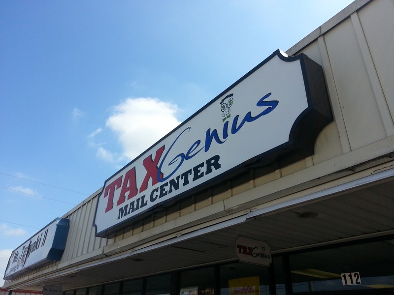

We used two guys and two ladders to install the face below. I believe it was 3' x 15'.
