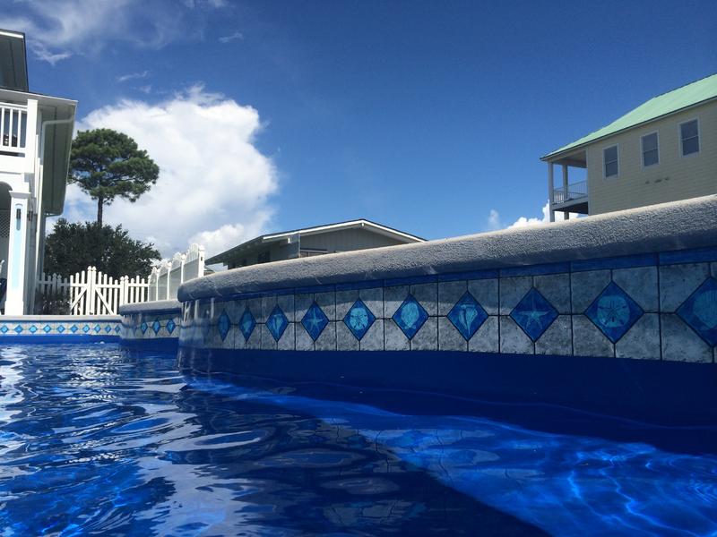

Here is a pic of a waterline tile we did in a pool, not bottom print, but still the bottom 1/2 is under the water at all times. I can't find any good pics of ones on the bottom.
