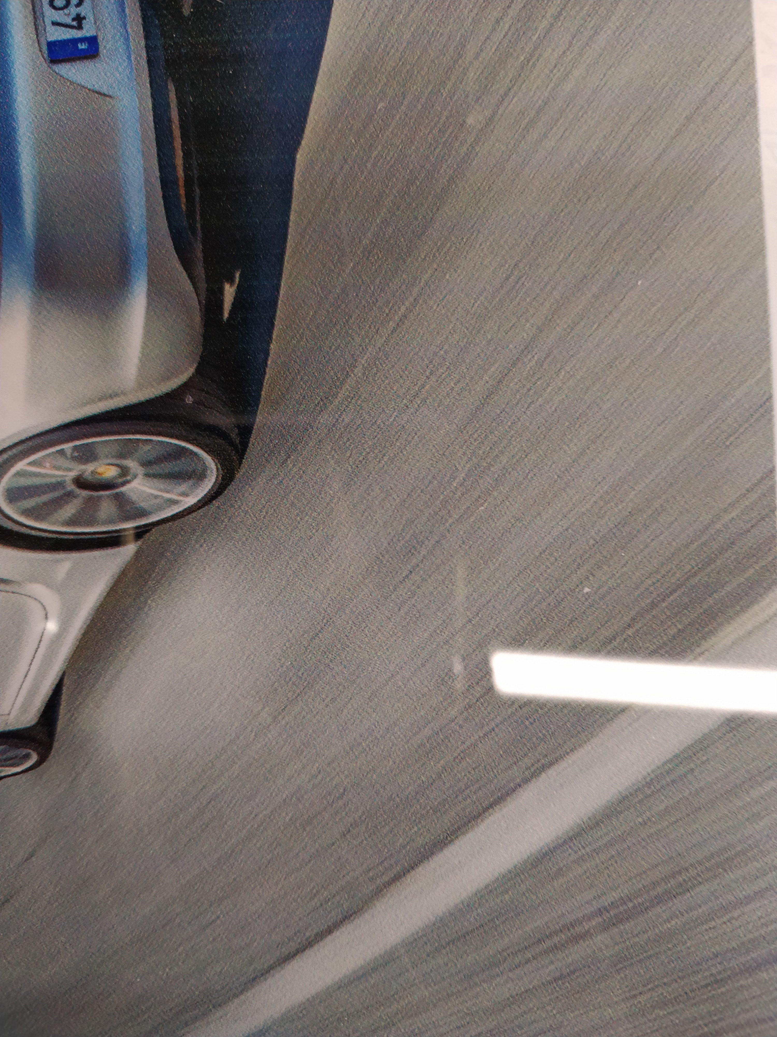

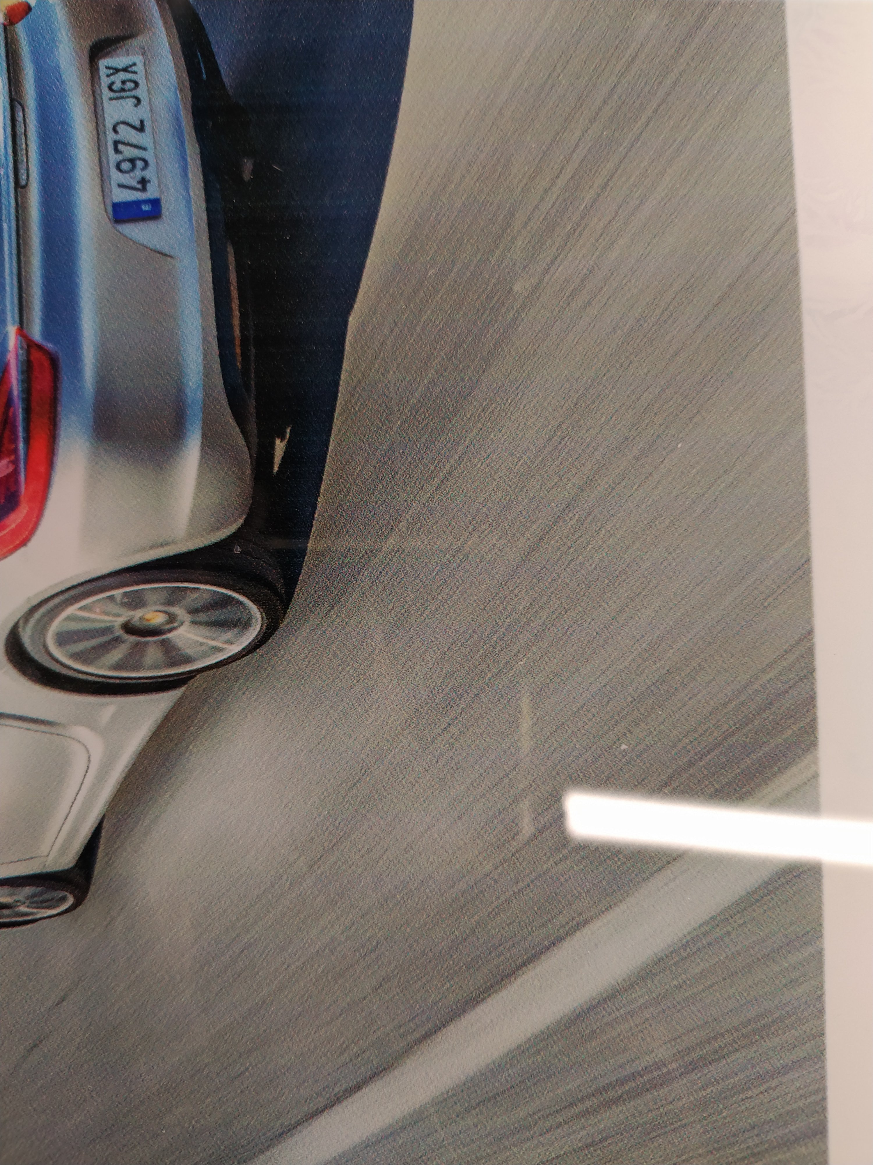

Good morning mate and thanks for answering. I attach a couple of photos. As you can see, the head pitch is noticeable in the image.
I print on generic ijc257 medium, layered quality, since I want white on top of color.

How does your nozzle check look?
As it appears to be banding from missing nozzles.
I'd agree... blocked or deflecting nozzles.

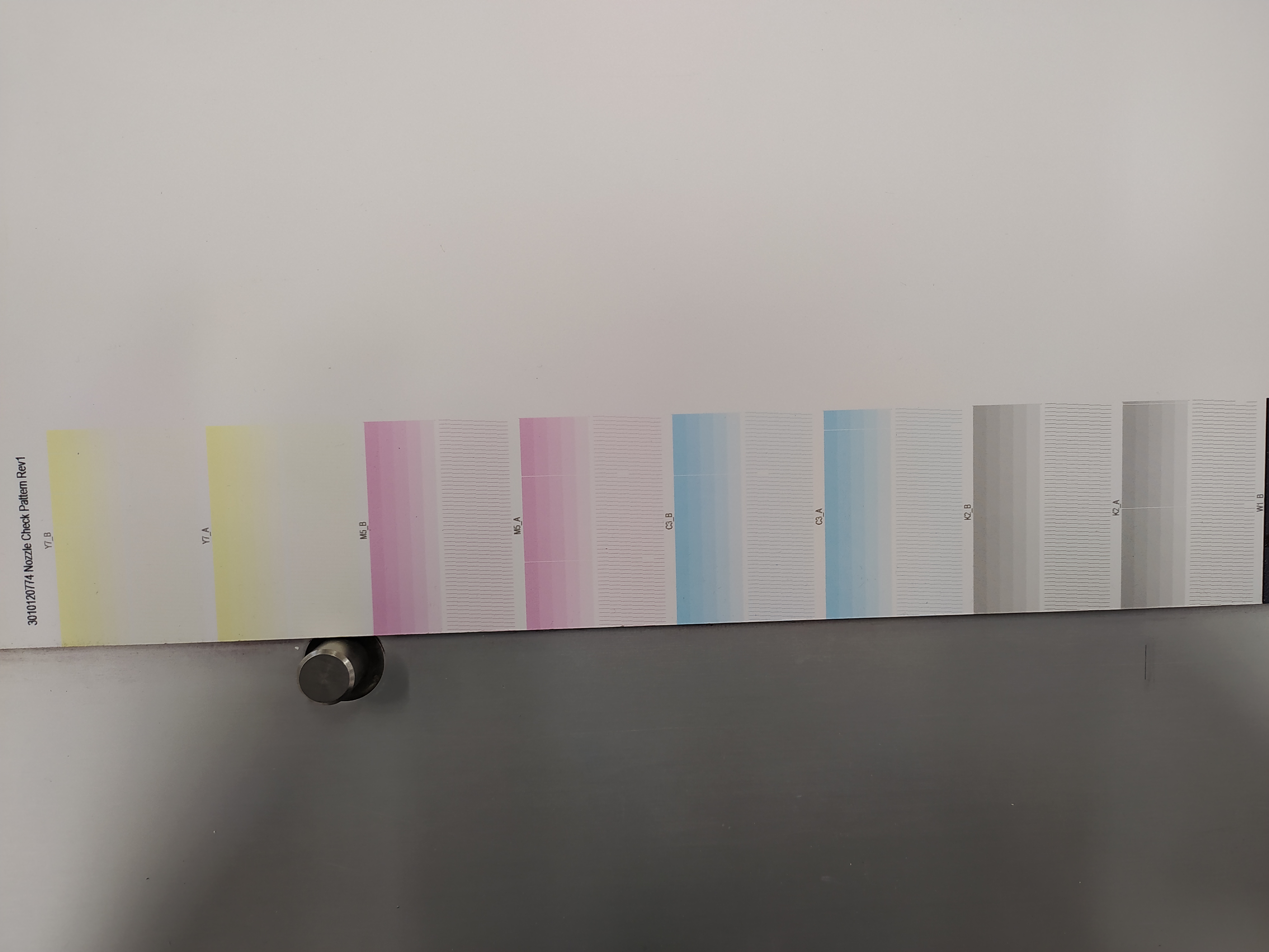

Good morning. I enclose a sample of the test.
Indeed, the machine is second-hand and from the beginning it has happened.
To say that there is a problem with the white heads, since from one day to the next the nozzles are blocked, requiring manual cleaning so that the tests come out perfect.
As you can see, some nozzles do not appear after cleaning, but I would say that it is not enough for a bad impression. It is not always the same nozzles that do not appear. On other occasions, after cleaning, there are others that are missing. That if, always of the same heads. Yellow never fails.
At least with my other machines, with a test like this, the machine would print fine.
I do not know if you can see something that escapes me, or that I do not know since I have never used an Oce. Since it prints well on other materials, I'm inclined to think that it's due to a poor media profile.

To be clear, it's not the media profile. Media profile wouldn't cause any banding as you'd see.
Are you running an ionizer bar? it could be static issues.
