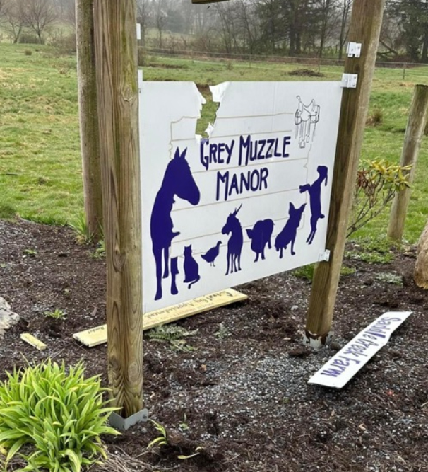

One or two sided ?? 3mm is not enough support for itself to hold up to weather conditions, especially cold and wind or snow plows. A site sin in our area should be at least 6mm and most of them are now 10mm. We have 4 separate site signs at 6' x 8', 4' x 8' and 2 at 8' 8' all on 10 mm. 3 are single-sided. They will still have frames built within the sign area.
Are you talking about ACM? That seems overkill. I've done a bunch of these 3mm and most just get slapped on a sheet of plywood for a rigid backer.
Just a temporary site sign, right?
6mm acm was not vandalism. They're not sure what caused it. Only 1.5 years old.
