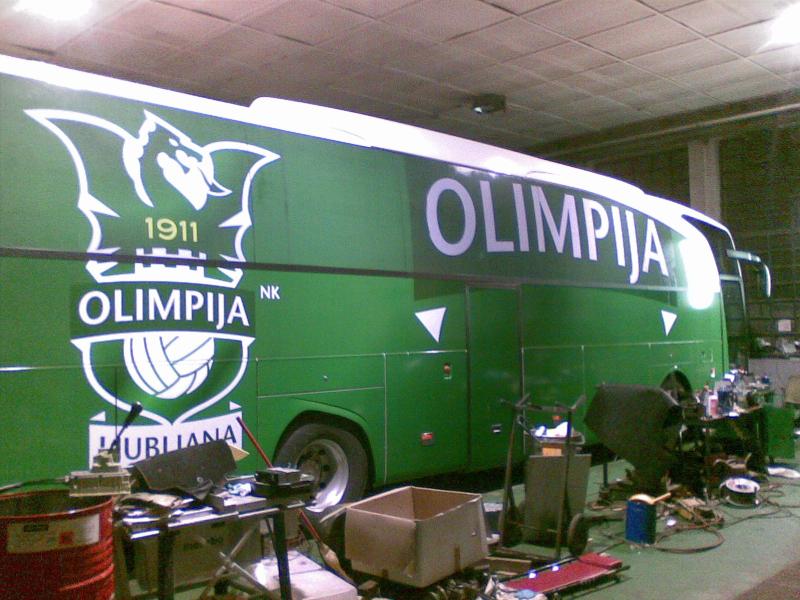

ok. our first bus wrap was going on like this...
on friday 29.jan at around 14pm, we got confirmed job. Design came in around 17pm. The customer wantend that the bus should be done by Wendsday morning (it goes on trip in early morning). And we took measures on bus stop, when bus came in, and pepole were getting off... in meanwhale we took measurement... Offcourse everything was approximately, so, some prints didnt match (look logo on picture) So, we printed throu weekend and on monday and tuesday. Bus was ready to wrap on monday morning. So, by thursday late evening we manage to wrap both sides (with windows) and rear. We didnt do front and part above windows. I must say, that im dissapointed that the customer gave as such short time to do the wrap, and becouse of the hurry, we did a lot of mistakes, that we will must repair... When they were asking for pro-forma invoice there was no talking about such short time! So we probably lose some money and a lot of nerves! But job is a job, you can take it or leave it... and we took it... next time... we will insist to have atleast 1,5 week to prepare...
i attach one picture i have got...

V-Engrave;
Really? i dont watch sports so much, so i dont know... Yes, it is customer design! And when we wrap it, they noticed that the dragons head shold be turned in other side (left). I know... Crap!!!
