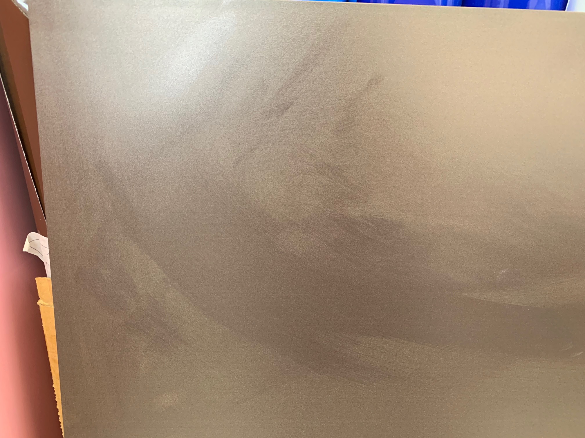

StarSign
This is what we get when cleaning ACM with 99% this is after wiping and letting sit 20 min before printing.

Wipe with Iso 91% and then dry and buff out. Looks great when you print.....
Personally, I spray directly ONTO the aluminum or coro or anything else Im cleaning that way. Its amazing how you see fingerprints or hand swipes on non masked substrates. Do not let the Iso sit on the substrate.
Yeah, what he said. Wipe it around cleaning it , but keep wiping til it's dry. Don't let it air dry or you'll get the streaks and hazing Star mentioned.
