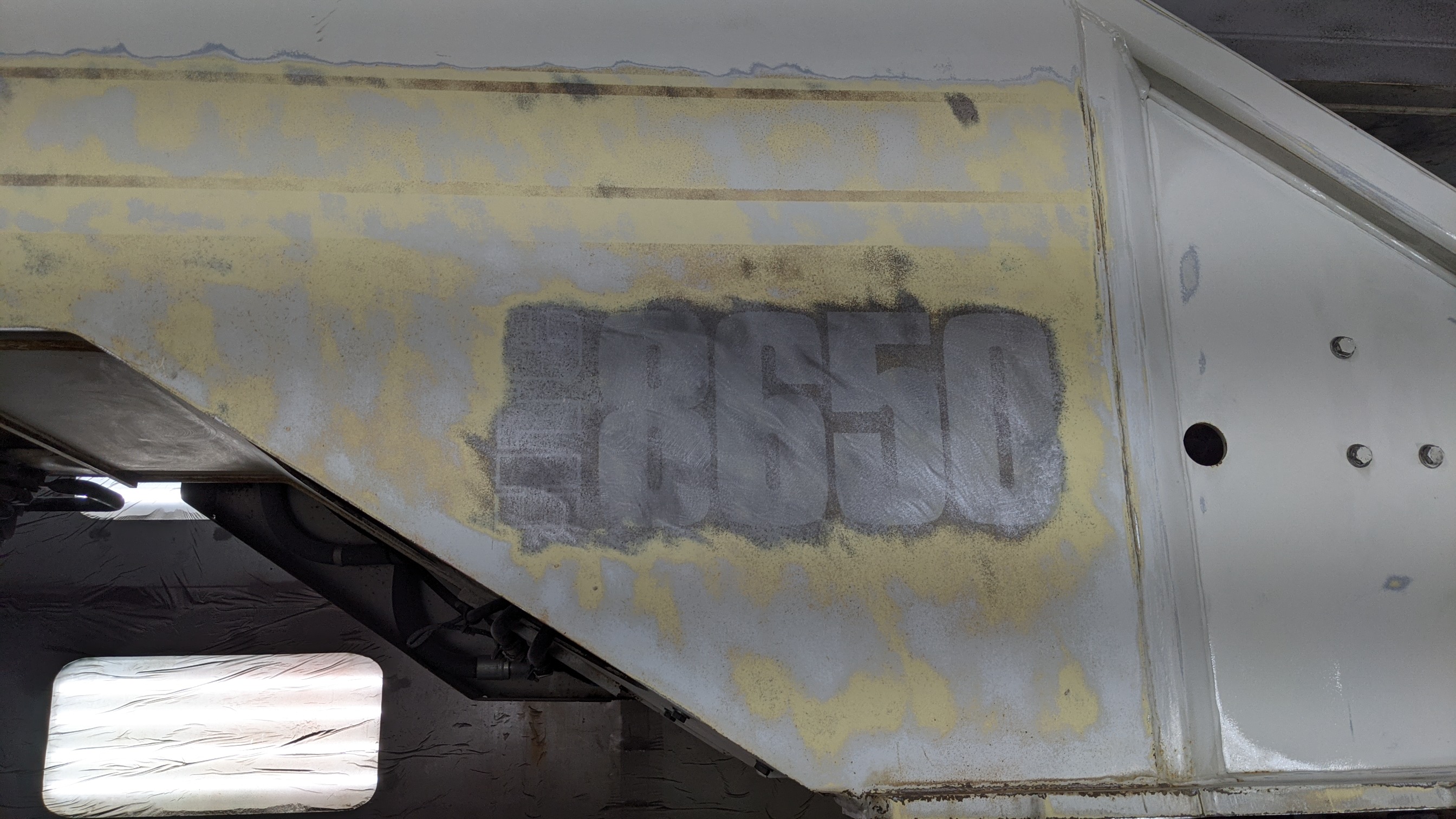

This is an older crane but it shows that there isn't much of anything you can do to eliminate the risk. This is down in the steel itself through paint and primer

That looks like a clear cut case of ink outgassing migration which could not escape through the laminate, so it went out through the glue side and embedded itself into the steel. I'll bet ya they didn't allow the outgassing for 48 hours and forced it to react in this manner.
And put it over paint that had not sat and cured for 3 months?

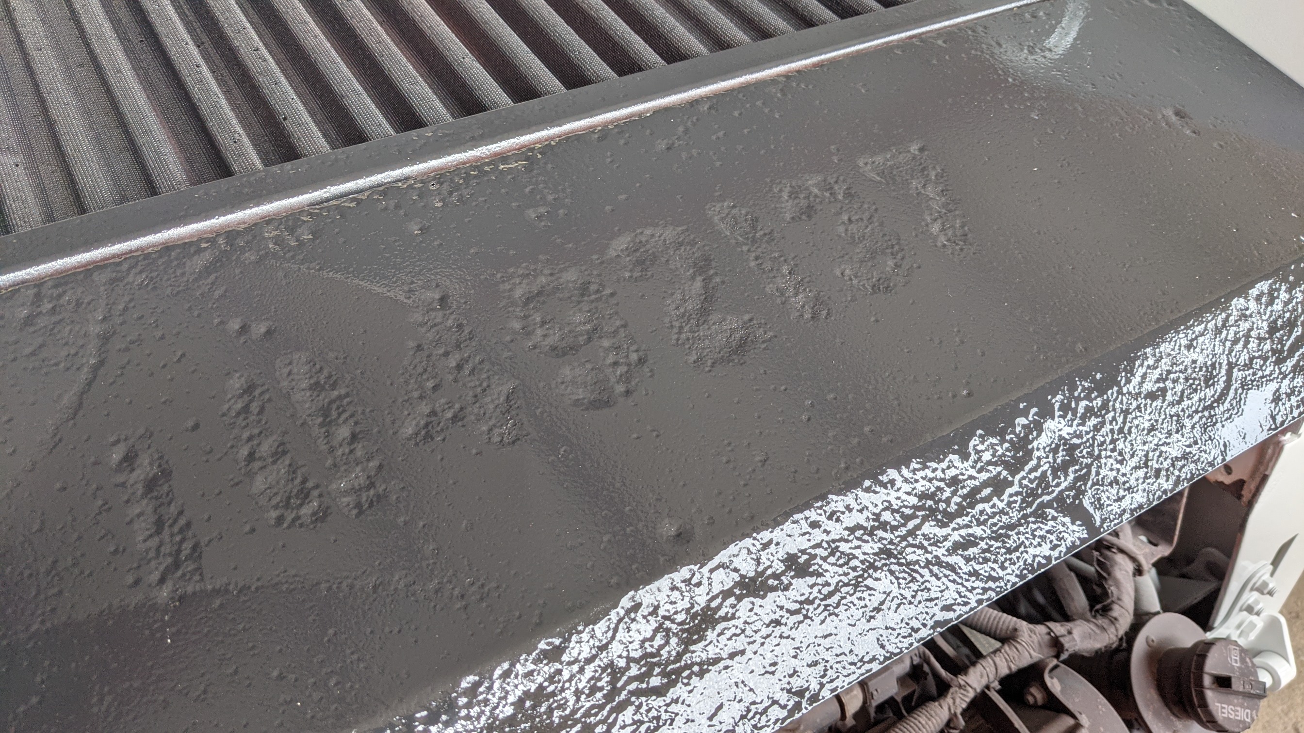

Don't know how to stop that one, but this will get it back to normal......

That's not ghosting. I think ghosting stops at the point at which you can feel it, but that's arguing semantics. Is that an area frequently spilled upon, where the lettered paint absorbed/retained more caustic chemicals than the base paint?
Mr Burton, lets try to stay on topic here, this is clearly ghosting. I thought someone might have wet applied it and got their ratio of soap off balance. Like 5 drops instead of 2? Or used palmolive instead of dawn?
That doesn't look like a misused soap alteration, but more like....... The Devil Did IT.

So you're saying that you used the correct soap and water ratio? Maybe it should be distilled water? Some of the tap water down here is pretty bad

Now I'm not going to say you're out right wrong, ghosting to me is a finish problem, once it's gotten beyond paint, it becomes a whole new issue. Like to me, ghosting implies a simple solution (which we know the only real solution is to install inverted graphics and wait XX years for the sun to bake the rest of the paint to the same finished product), where as that particular situation is going to require fillers and build up to get it back to halfway smooth.
Well then Mr Burton, wouldn't you agree that this started as a finish problem? Maybe like ghosting? So is ghosting the virus that causes the un-named disease that has happened here?
We didn't put any filler in it either, just shot right over it. Figured we'd save them the 5 bucks that a new decal would cost, that's how we keep them coming back.
