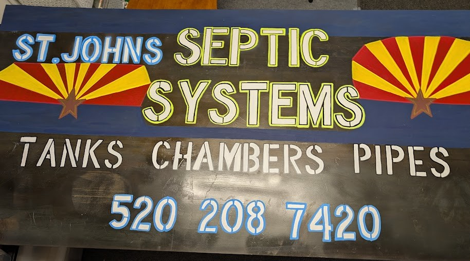

I don't need to try, every time I try to write large to label something, it runs off one side and my letters are either crowded or off center.
No give me a knife and I'll make 10 straight cuts in a row, but with a pen or pencil and I'm on par with my 7 year old.
Oh yeah same here. I can freehand just about anything with an olfa or x-acto, or even a sharpie for that matter, but I bet I couldn't hand-letter a clean shape if my life depended on it.

Beauty is in the eye of the beholder, if the customer likes it, sell it as is. If it's something you find disappointing, it's on you to redo until you'd be satisfied passing it every day.
Props on taking one on the chin from Gino and not bellyaching, I believe he cut his teeth on hand lettering, he is a great resource. Not sure about the best way to go about learning hand lettering any more, but there are more than a few old salts on here that may point you in the right direction.
Thank you for the positive point, I am appreciative of the input and I have looked at it from a different point of view. I redid the areas suggested by Gino and it's some better but yes, needs to be redone, but for now it hangs. and yes surprisingly he paid me for it. Maybe a pity payment, but there's hope for a do over. Again thank you for feed back.
Ya know, just for sh!ts and giggles, I looked into this one. There is no St John Septic with that area code. Also, there are other things which don't quite jive, either.
Unless this person comes forth, I believe I've been suckered.
Well, I guess I've been everyone's laugh for the day, a first sad attempt and yes, it is a real request, and yes, I got paid, more than it was worth and yes it reeks of armature bad first attempt and a redo will be in the works as soon as possible. It hangs though and number does work. I know full of errors and I will do homework, approach differently. I have alot to learn, but glad for the experience. I did suggest the client just go online and order one direct from professionals. Thanks for your input I did spend some time fixing as best I could your highlighted suggestions. I'd post but lynching might be next so I will slide away quietly. Thanks though for the input.
Totally, if the guy like it and will pay ya, by all means, take it and move forward.
I was only trying to be helpful.

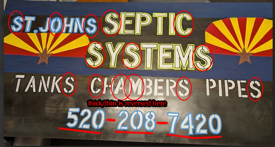

All flat letters will be the height setter, but the 'rounds' will be slightly above the height lines and below the bottom letter. It's an optical illusion. Most of your letters have completely different weights within the same word, let alone in the same line of copy. Some to most of your letters seem to be pointing slightly up, down, straight ahead and somewhat different heights. Look at the #2 in the phone. They're all different sizes and the bottom dash is different in 2 of them. The 0's are different weights and the 8 looks like it has scurvy. Tanks, chambers & pipes runs uphill and almost off the paint band. Your tabs within the lettering is missing at a buncha places and the period in St. is outta proportion. Ya probably should have something between the 3 words to define them better.
Pure..... there's more, but try to digest this and we'll move forward later, if ya wanna.

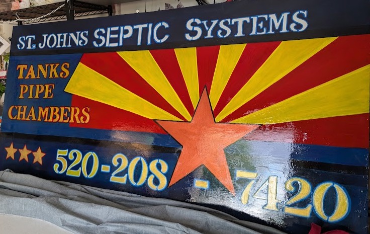

I did try to fix those points, and side two was better and I may try again smaller and different substrate. I appreciate your time. Yes letters would look better all the same font and size. Need better tools. Way harder than I expected.. lol

I had to make sure this was real it looked a little chinese flagish to me. IT'S REAL! I called the number and spoke with the owner, a very nice man. I told him the sign hit a sign forum and he has lots of people from across the US that like his sign! He texted me a couple photos and he loves the sign! The gal who made this is an elderly woman. I told him the sign is beautiful and she did a fantastic job and he agreed. He is probably surprised but is very proud of the work this gal did.
Great job OP!
Gino - another happy ending!
