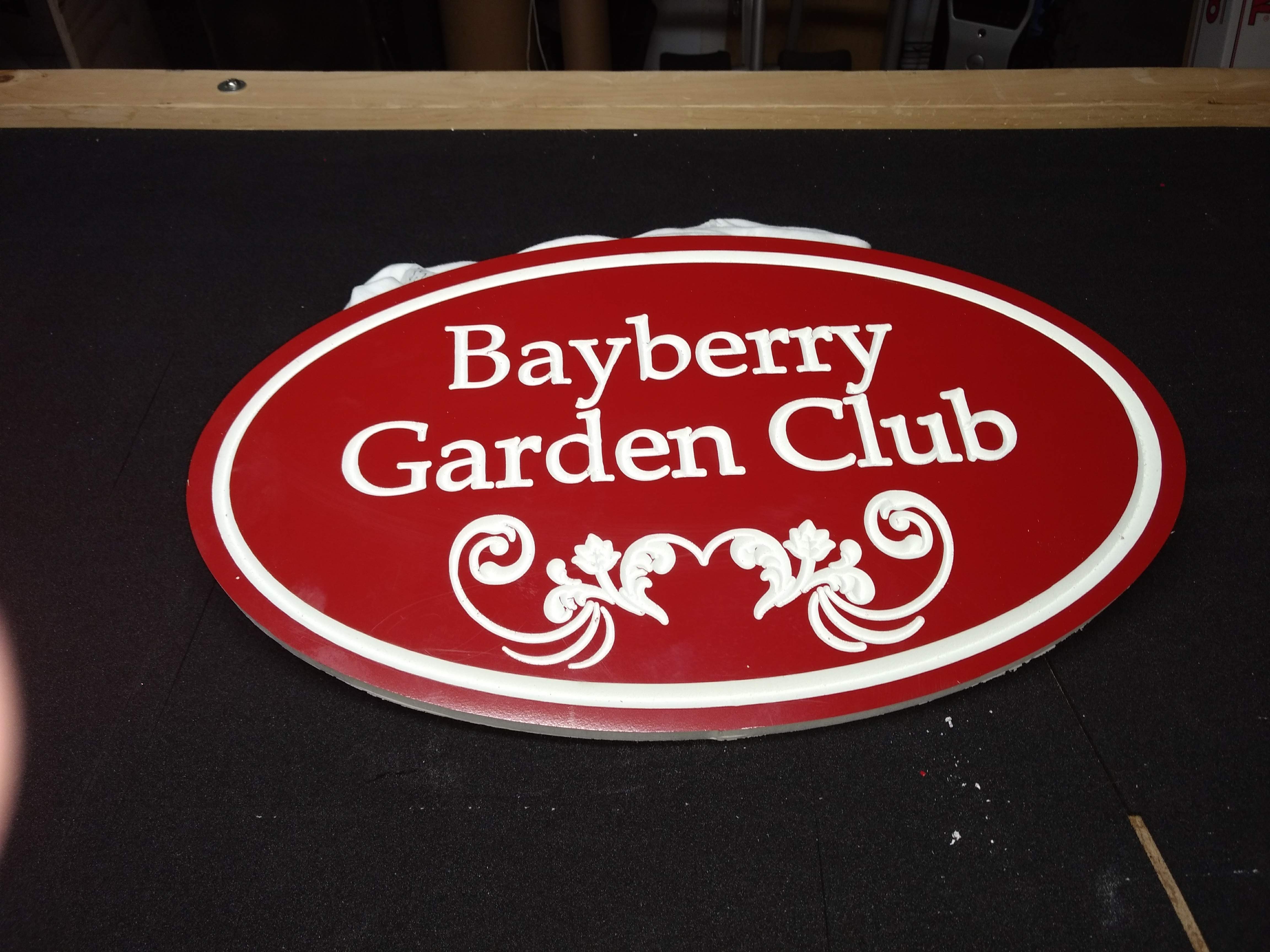

Hello,
Last August, I bought a second hand CNC machine (small 30”x48”) And I have been making a few signs here and there. After learning the process and the software and doing a bunch of jobs for Existing customers and friends I have become very comfortable with the process but not so comfortable with the pricing. I Have been making Signs that include v-carving and applied cut letters and graphics out of pvc and painted. I don’t want to unspdersell myself so looking for any input as to how others price. When it comes to This area the business I’m really not sure how to price I have been using a shop rate and materials with a mark up. Any advice from those who have been doing this aspect of the business for a while? I don’t wanna undersell the marketplace.

Ian, I havent done this for a a long time but I have a price structure that seems to have been working. What I do is use shop rate plus material & markup then I charge $75 - $100/hour for router time (including router setup & cleaning depending on the customer) on jobs with long run times I also charge for router bits. Like I said I havent done this long so my pricing may change over time.

I'd be between $250 and $1'000 for something like this.Depends if I got a drop laying around, the vinyl for the face, are they a PIA etc.To many unknowns to list what it's worth.
