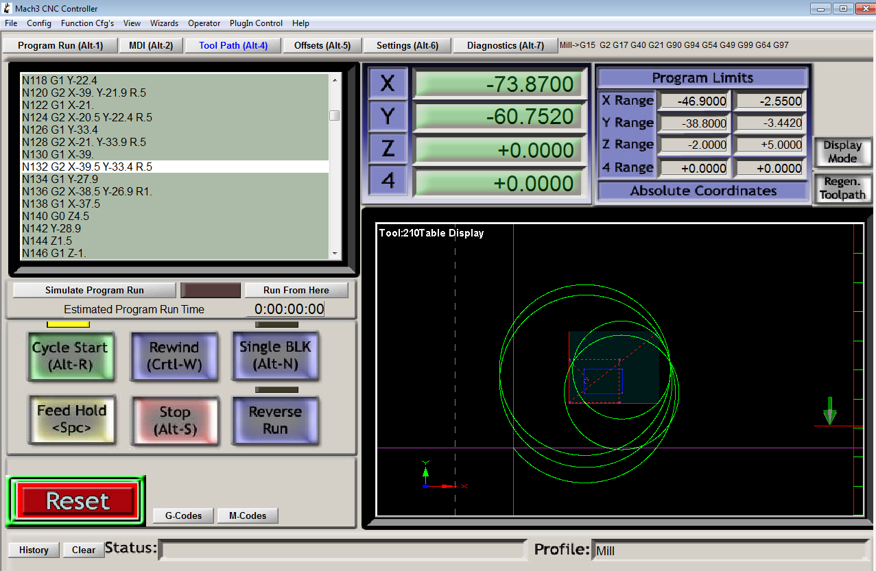

I guess I'm going to look up how to get the time estimation for cutting. I'm using Mach3 for the software that runs the actual code to the machine. So... I will go and look up how to find that as a next step.

Ah!... found where to estimate the run time based on current settings in Mach3. I'm going to go and think about what other things are involved... how long bits last, etc....

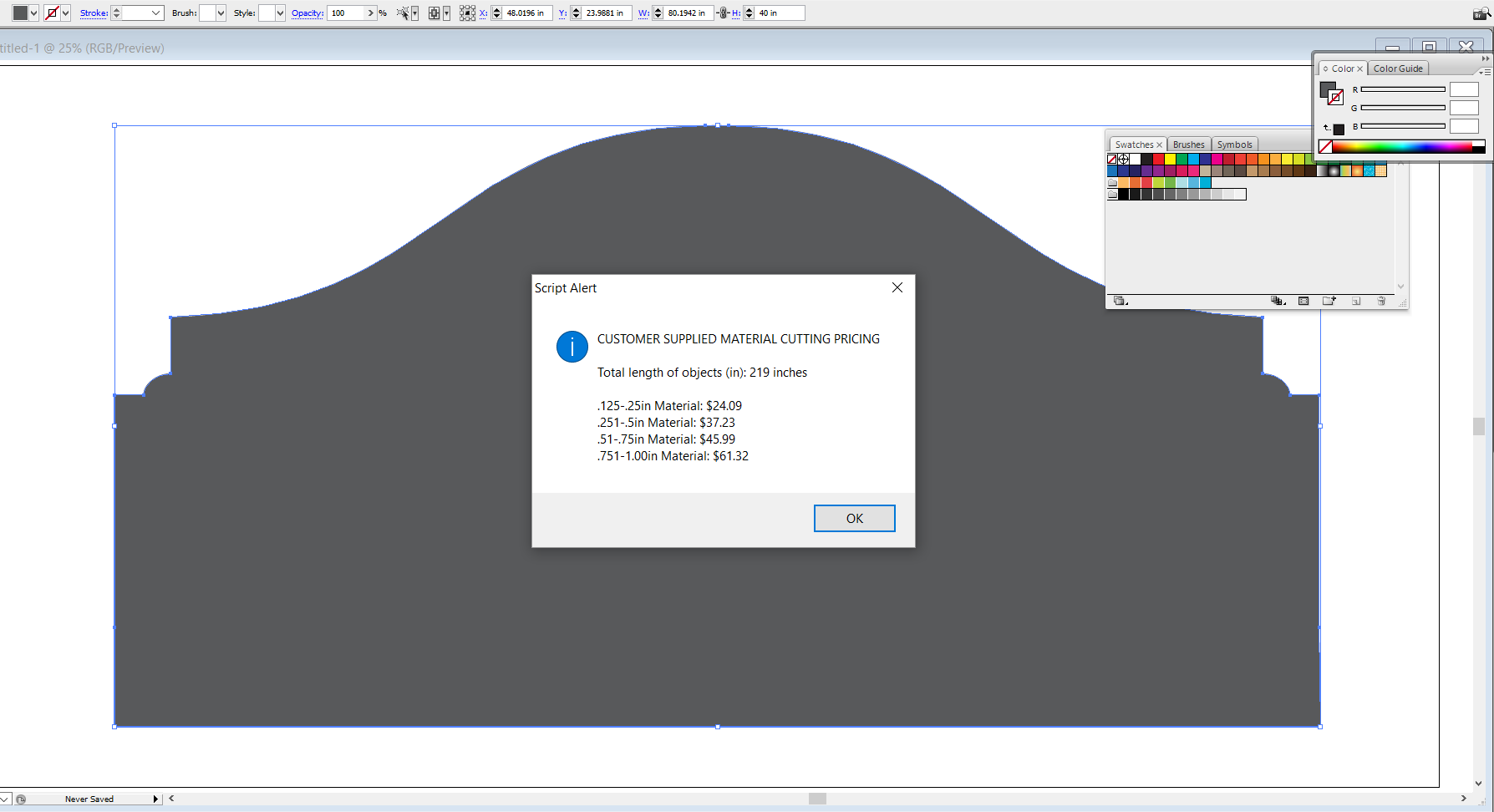

I have a script in Illustrator that takes the linear inches of the item and then uses that times a factor to spit out a cost based on material thickness/type.
I should add the biggest thing under estimated is setup time/time between sheets. Sticking the material on the bed, screwing it in place (which may not be necessary based on your setup but it's often a good idea), setting up your tool paths, putting in the right tool, zeroing the tool, running the job, unloading the sheet, and cleaning the table for the next job adds a good bit of time.
