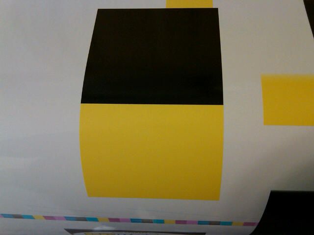

I send over 1 single blue box and this is what i get

does the prod mgr show 1 blue box or the yellow/black? and is the full size of both yellow/blcack box that same as the orig. blue? and can you export as eps and drag into prod mgr to produce a diff't result?
laserman70
it shows a blue box in production manager.

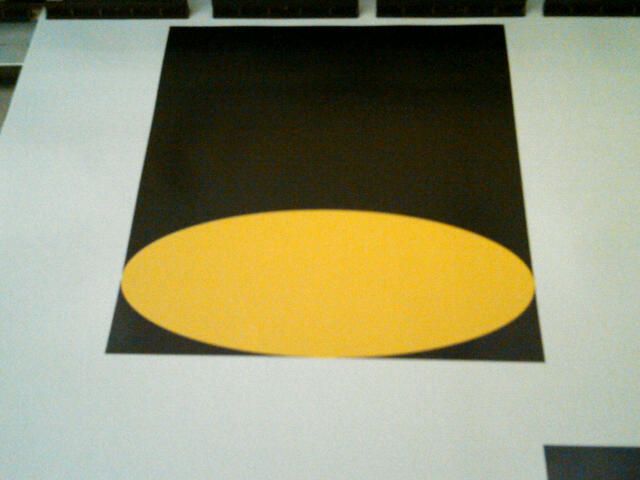

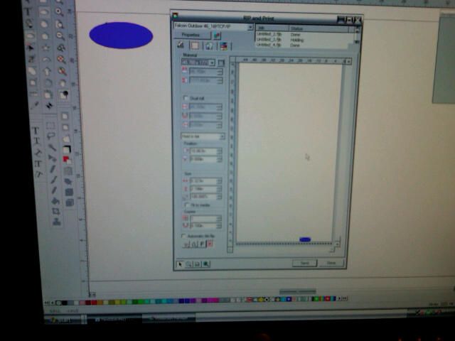

I printed a blue oval and this is what i got.
This is crazy...

CS-SignSupply
Close Flexi, then go to START>PROGRAMS>SAI>SAI PRODUCTION SUITE>PREFERENCES MANAGER
Choose - Factory Defaults
Then click the Load button at the bottom.
Restart your PC and start Flexi again. You will need to add your printer and other devices back into Production Manager so be sure to get all of the Port Settings written down before you do this.
laserman70
Thank you, Thank you, Thank you.....:thankyou::thankyou::thankyou::U Rock:
