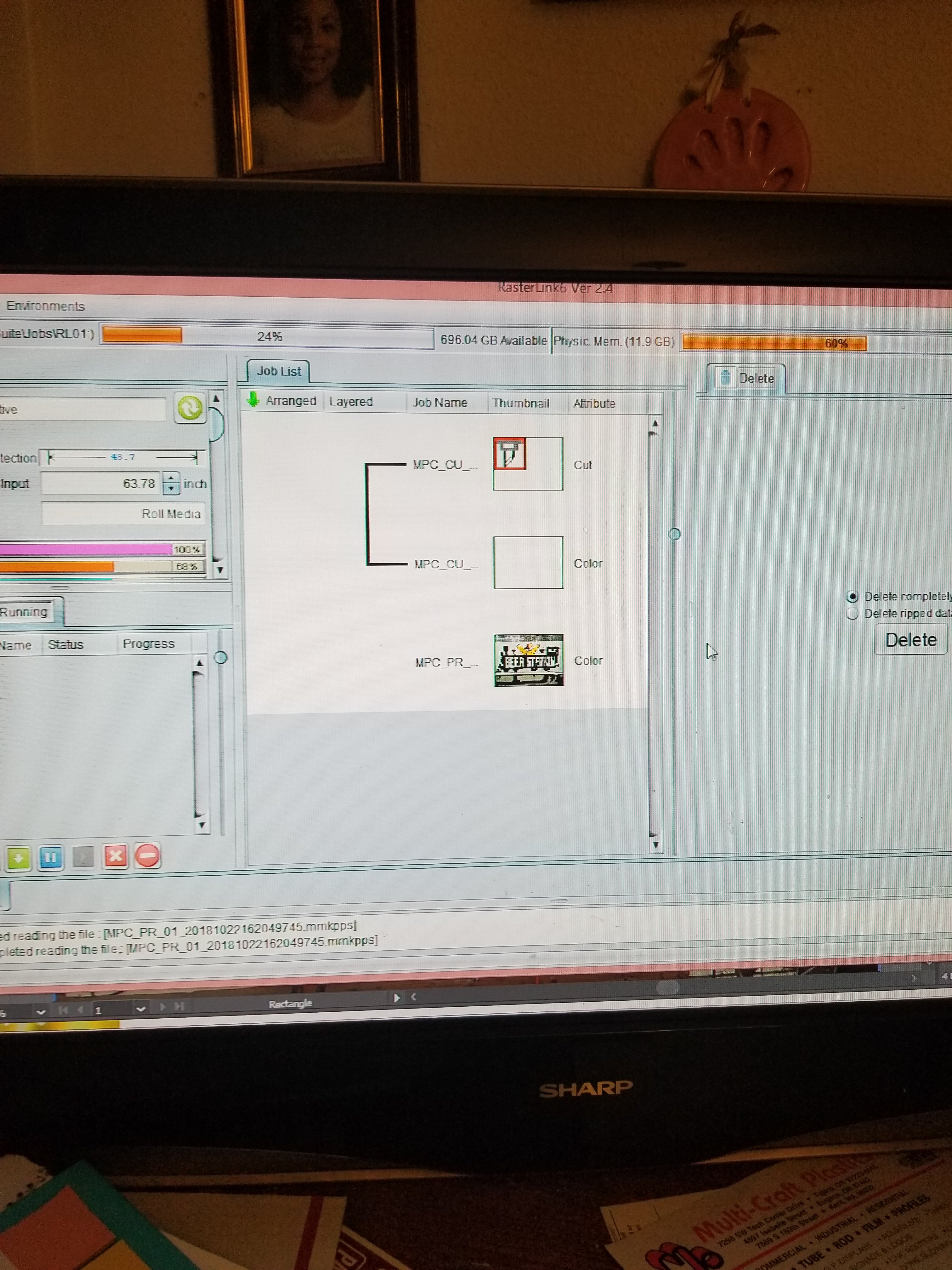

Thanks for all the replies.. Vander J , I definitely have the print set to print and am trying to figure out how to change the spot color and change to PDF .. yet the cutting at this time is not the issue.. I have attached a pic of what i am seeing.. Where it says color {connected to cut} is blank... i have never been able to transfer over and image to print w/ print and cut.. but it does transfer over w/ only Print...

Send a screenshot of your FineCut settings when you send the files through. It looks like something is not right because in the screenshot you took the print layer is actually being seen as another cut layer. Notice after the MPC_ it says CU on both layers but on your print only one it says PR? On the print cut job 1 should be CU and the other PR. You might need to go empty out the hot folder if there are any files in there.

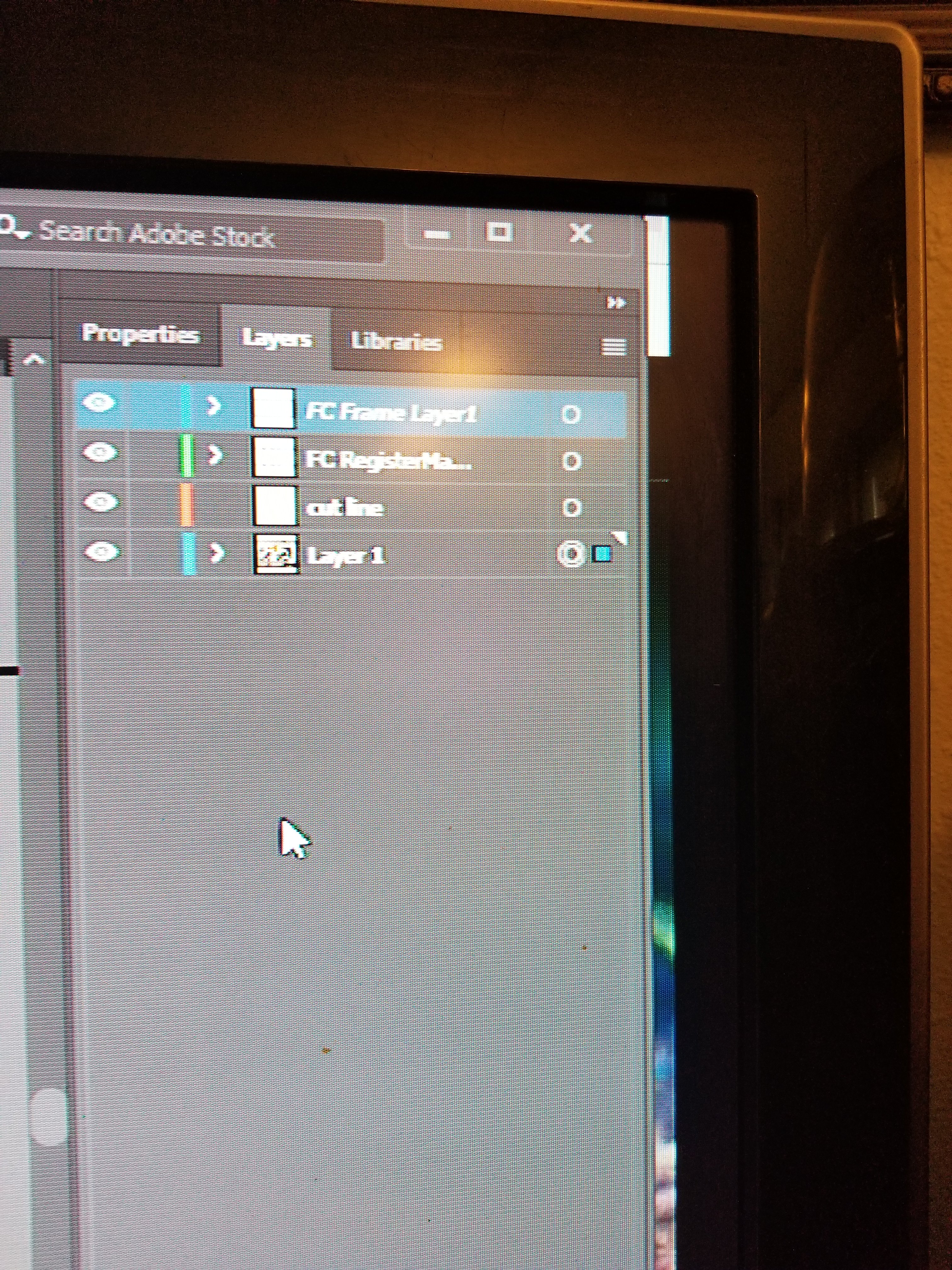

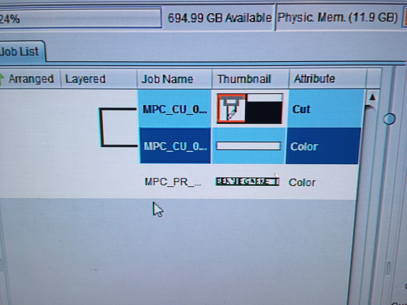

here are screen shots from FineCUt. and and RasterLink... no matter what combination i use it continues to reflect to CU's I may be forced to go w/ flexi or Sign Lab.. lotta hours spent on this

UPDATE: Of all the dumb mistakes - I did not correctly specify the Hot Folder. When I chose the folder that RasterLink 6 had decided upon (!), and made that the hot folder when selecting the "RL" button in FineCut, and select Hot folder, suddenly the file is correctly split between color and cut, and not color (which was blank), cut > connected, and a third file of color done right, but would not be cut.
