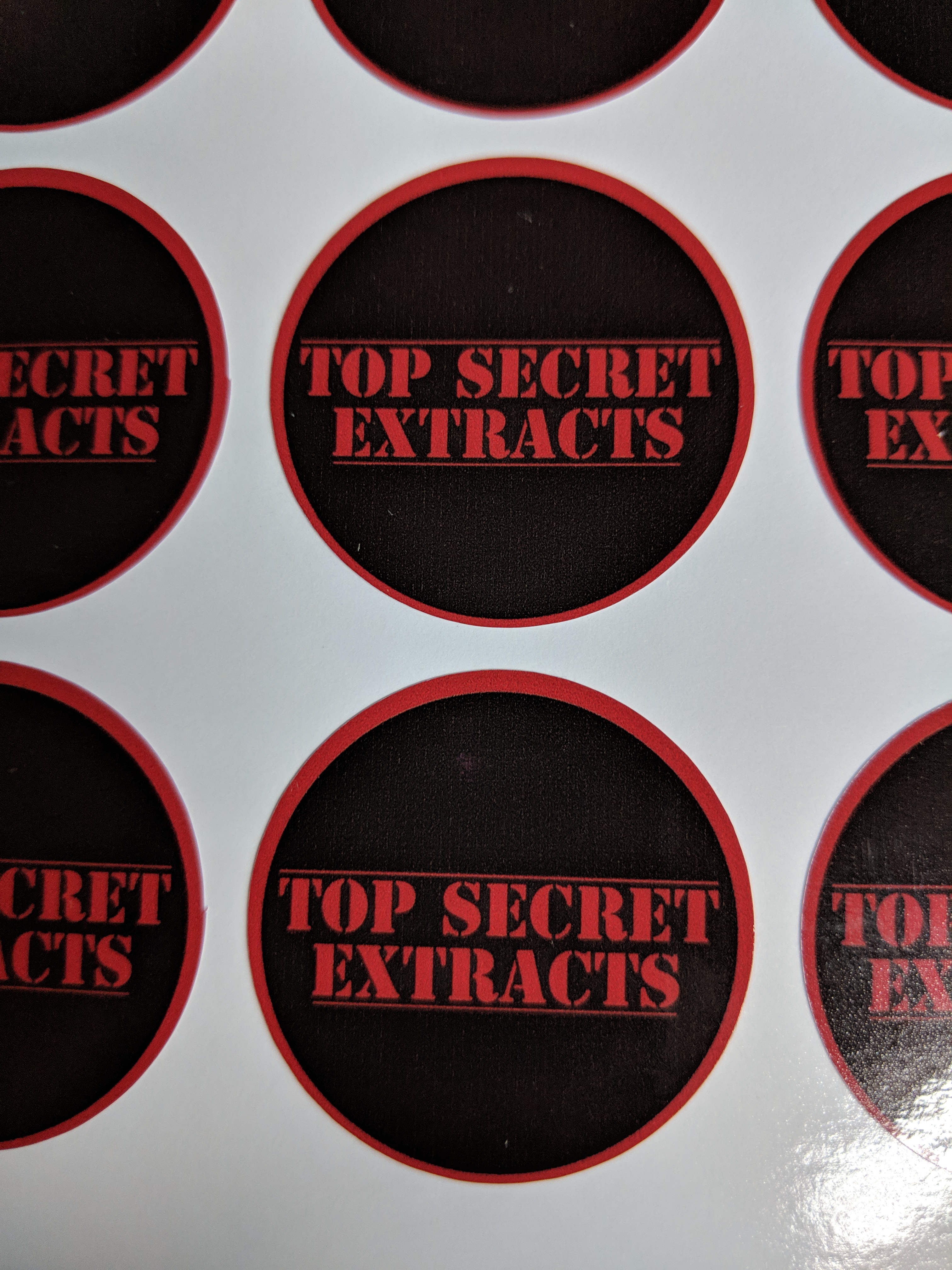

This has probably been beaten to death but I'm having alignment issues on my print and cut. As you can see in the image it's off slightly and the circle is 1.5" round. I've gone through numerous calibrations and it still comes out the same. I'm tired of throwing material away for bad cutting.
Thanks

Offset will be set by the blade type, so normally 0.25 (is in UK anyway!), obvious one but have you done your print and cut calibration?
Are they laminated?
The media could be expanding/contracting from the heater settings.
Pinch wheels and grit rollers all clean?
Does it do this on all jobs?

It may but it might be slight that I can't notice, you can tell on these small border of a circle though.
It may be a little bit of that. I actually went into the service mode and adjusted the print and cut setting and they were off a bit. I got it tightened up a little bit more.

I have been having issues with cutting my prints (HP560, cut on Q54) intermittently. No matter how carefully I set it up, the cuts would be off just slightly. I was also having a lot of headstrikes while printing, and finally dropped the heat down several notches to keep my vinyl from buckling. Since I have done that, my cuts have been pretty much dead on. So I figure the extra heat was expanding the vinyl enough that once cooled, it contracted and caused the cutting issue. So yes, drop your heat to where it still cures the ink, but doesn't warp the vinyl.
