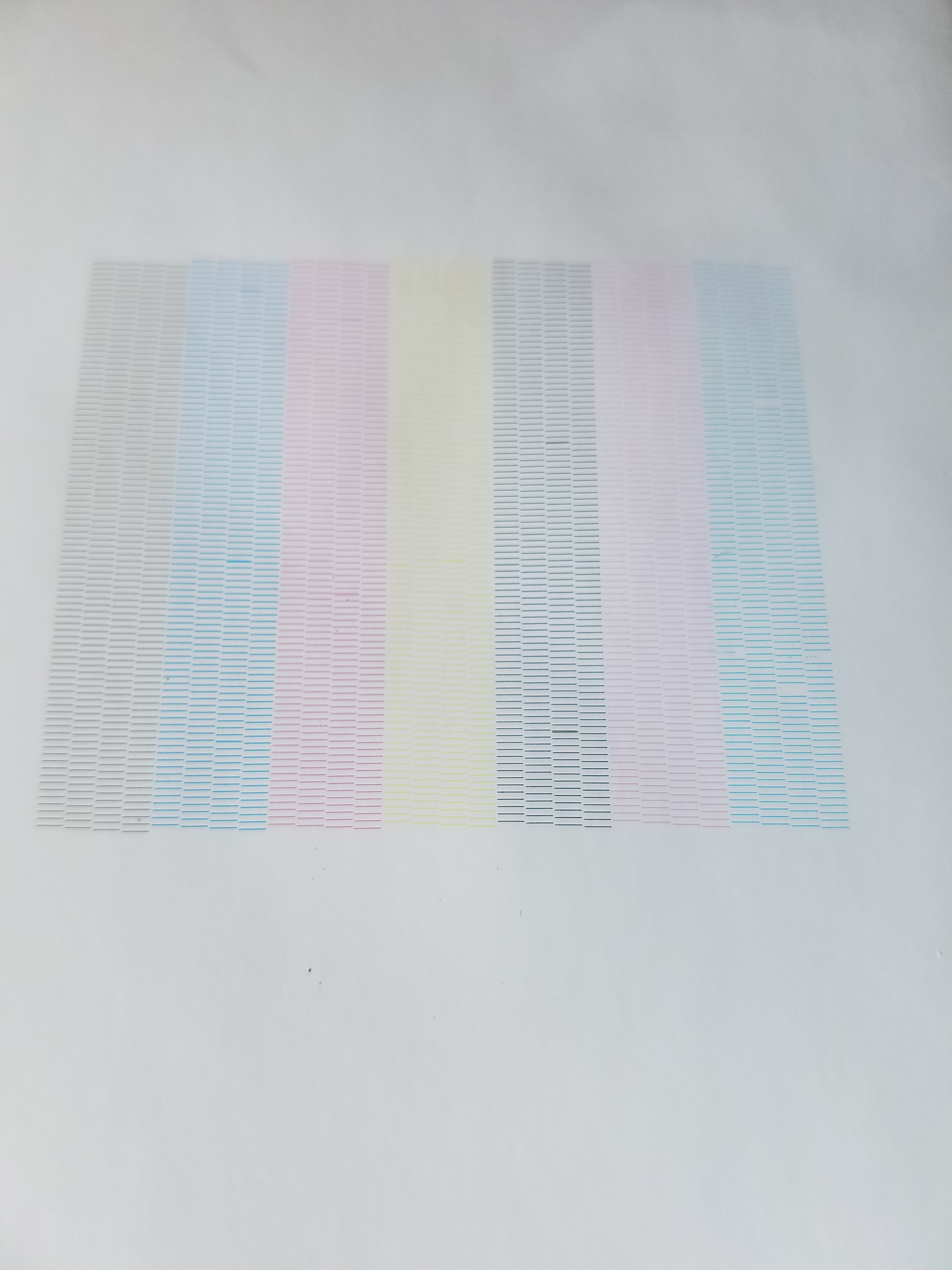

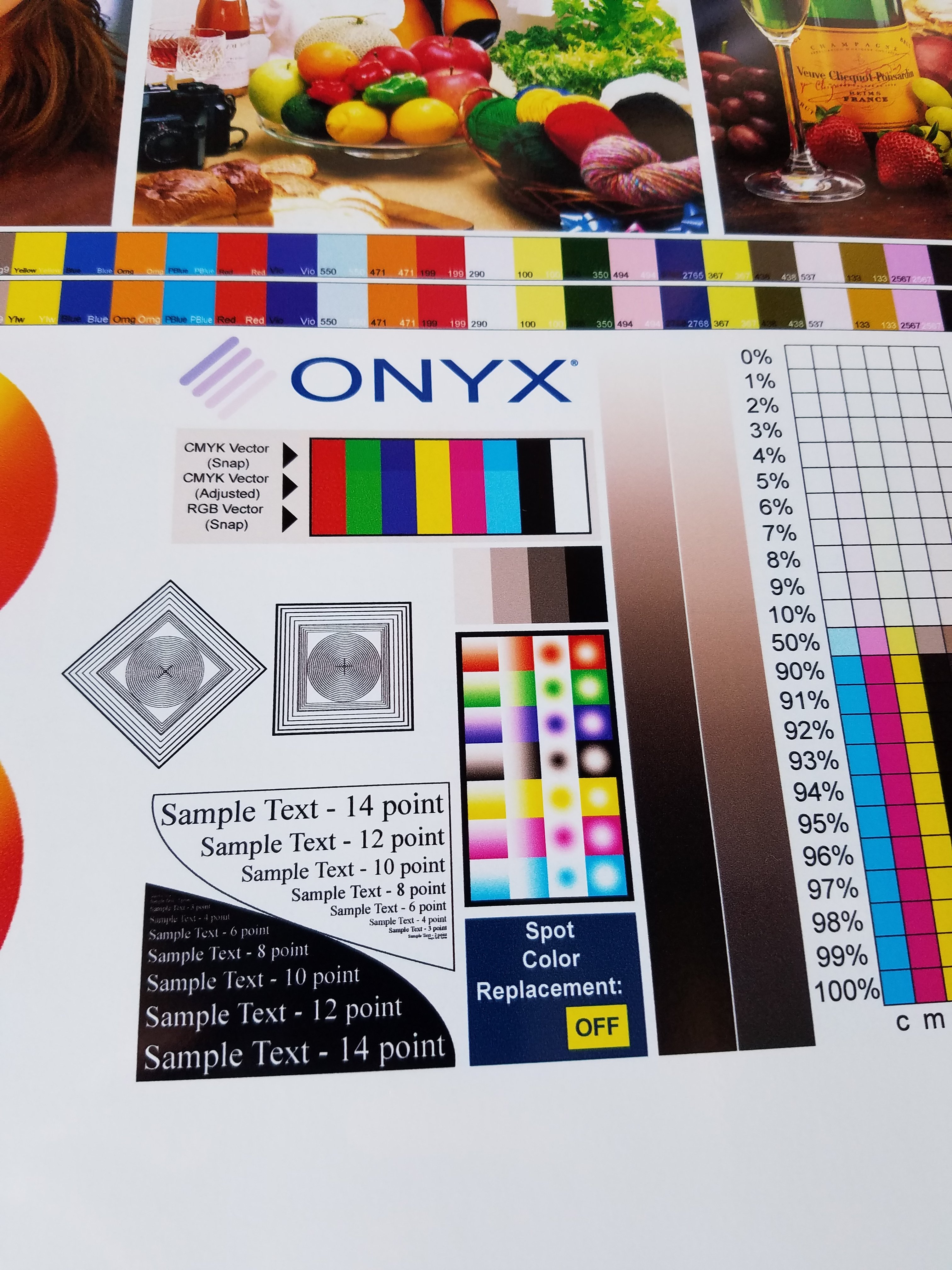

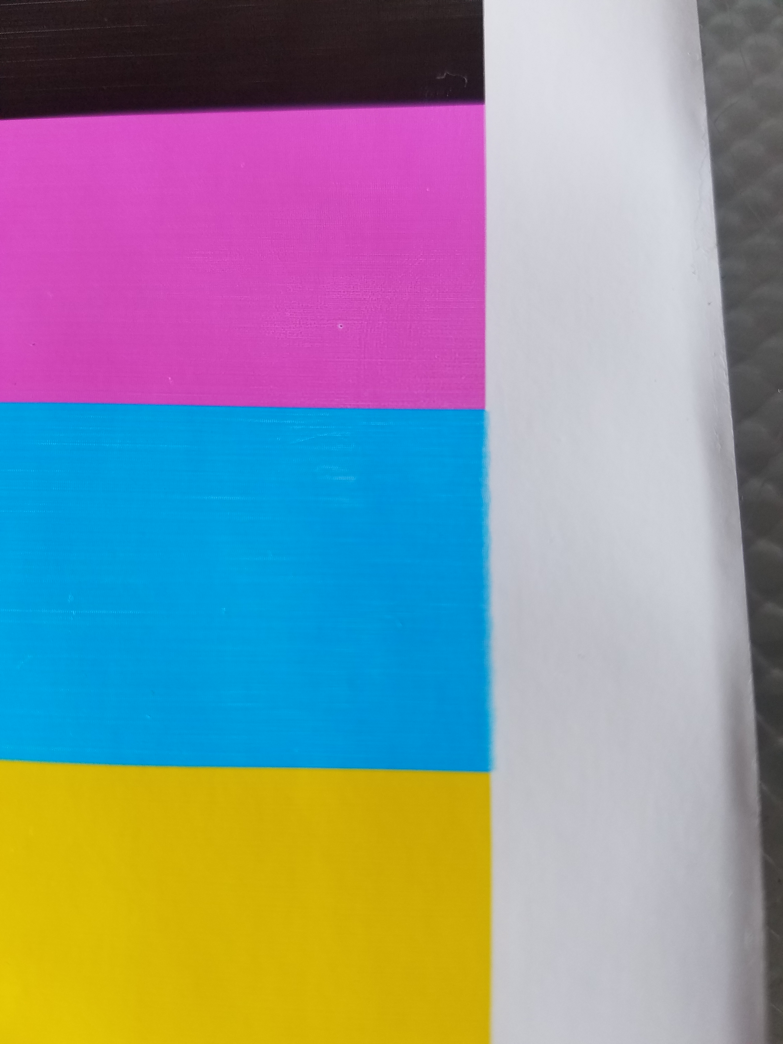

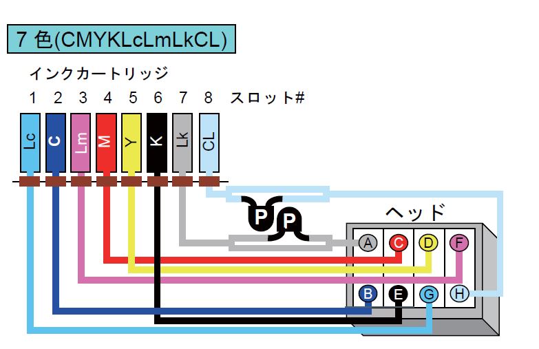

Here are the results , It does look like the LC is an issue . I don't think it can be a damper as 2 lines go to it , so another color should be bad as well ? LC damper is shared with Yellow , so if damper is bad I would only assume yellow would use issues as well ?
Anyway , let me know .
