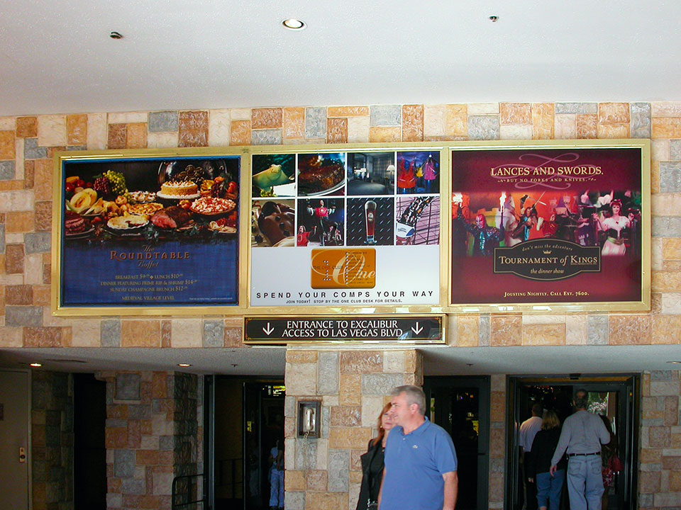

Day / night specifies one needs to perceive the graphic both during the day and at night equally well.
The attached image happens to be Kodak Day/Night Duratrans which used a single translucent photographic film media. This installation receives full sun from the West every cloudless day and appears equally well as it does at night while its backlit.
