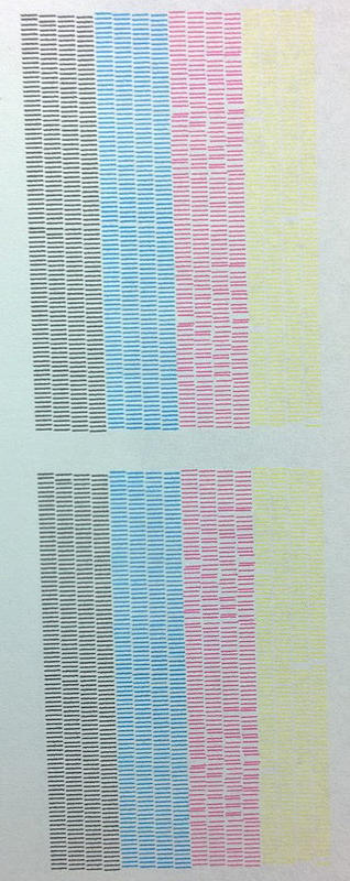

Hi all,
My printer Roland Sp 540v,the magenta pattern test print out not even!!?
What happen, need your help ideal how to fix. See the attached pic.
Thanks
Brainnew
rjssigns
Magenta has tons of deflection from head strikes. You also have blocked nozzles.
Gotta ask what ink you're using. If it's third party that could be causing the blockages. If not the head is probably toast.
Either way you should probably get a good tech on site.
brainnew
print pattern not even
Thanks Rjssigns for your ideal.
Its may strike to the edge of media, its happened one time. I used third party ink a long time, even the black and blue. I would waiting more suggest before replacing a new head. Thanks again.
Brainnew.
kanini
You could try to do a head soak and see if it gets any better but since you have mostly deflections and not clogs I agree with Rjssigns and it could be time for head replacement.
brainnew
Print pattern not even
It still printing but I have print at high quality...to reduce the banding. I will try to soak it later, I should buy new print head, its ready for worst time.
Thanks for all your suggestion
Brainnew
CS-SignSupply
Soaking may help a few nozzles but permanently deflected nozzles are just that. Replacing the head is my recommendation.
When was the last time you cleaned and/or replaced the wipers, scraper, serge sponge and captops?
brainnew
print head problem print test pattern not even
I have been soak the head, all damper, sponge, scraper, pump line just replace two month ago...
Its time to replace a new printer head
Thanks for all your time and suggestion
