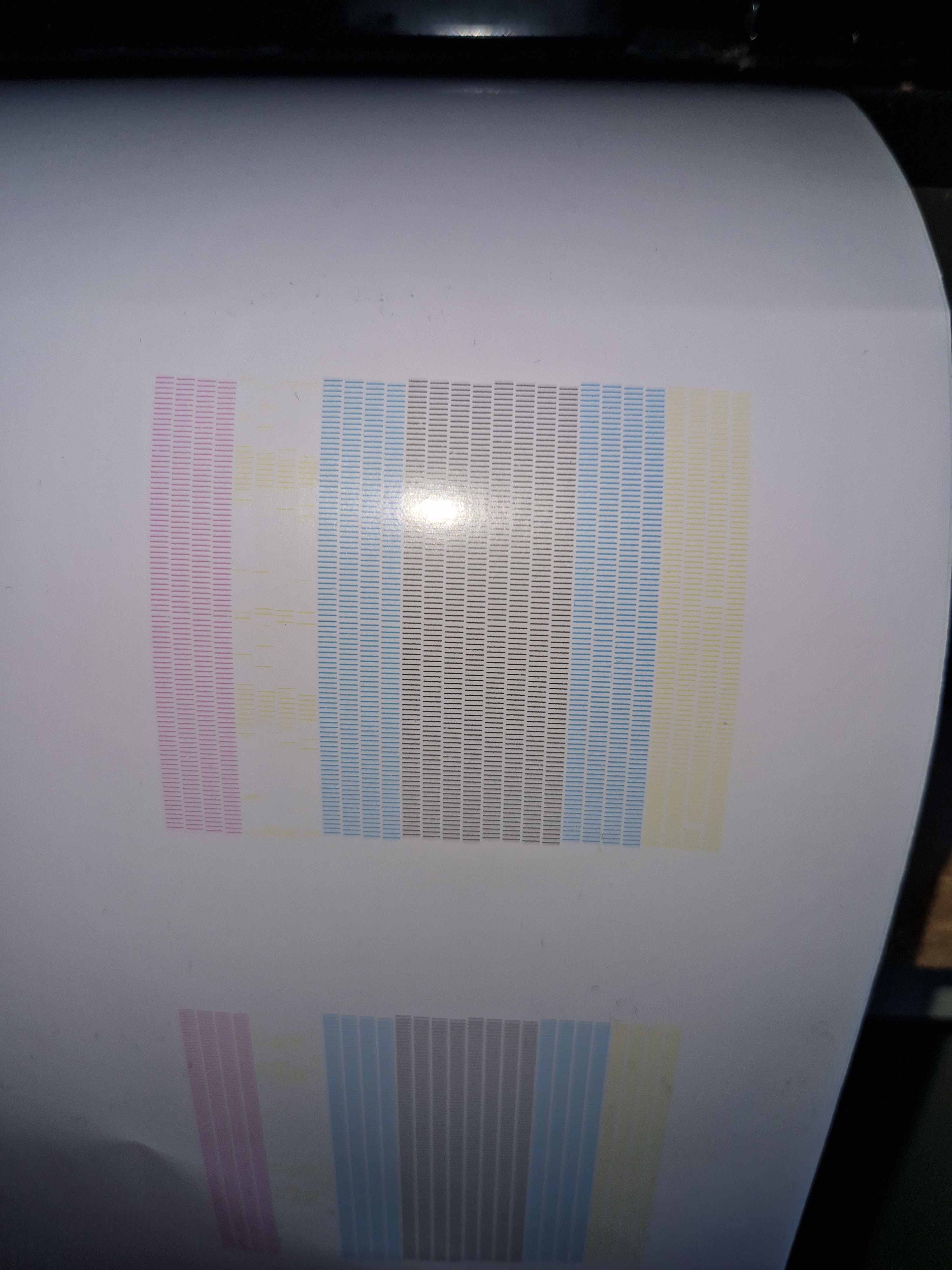

Hello, I just installed OEM dampers, for the moment the yellow is back to 75% (I have the left line half empty), despite several cleanings it does not change anything ... I have a new OEM cap top and a non-OEM pump here do you think I should install them? 1000017081.jpg 1000017082.jpg
damonCA21
Yes you need to install the OEM cap top. The pump seems to be working fine as it is cleaning the other colours fine. The yellow head is probably clogged from sitting now, so you need a cap top that is working correctly

Hello, after changing the captop I still have the same problem, I do not understand where it can come from everything is new.
sekorse
Hello, I've cleaned up but there aren't many more nozzles, some disappear, some appear, I tried a yellow print and the beginning didn't print for 4cm, then the yellow appeared but still with lines due to the missing nozzles...

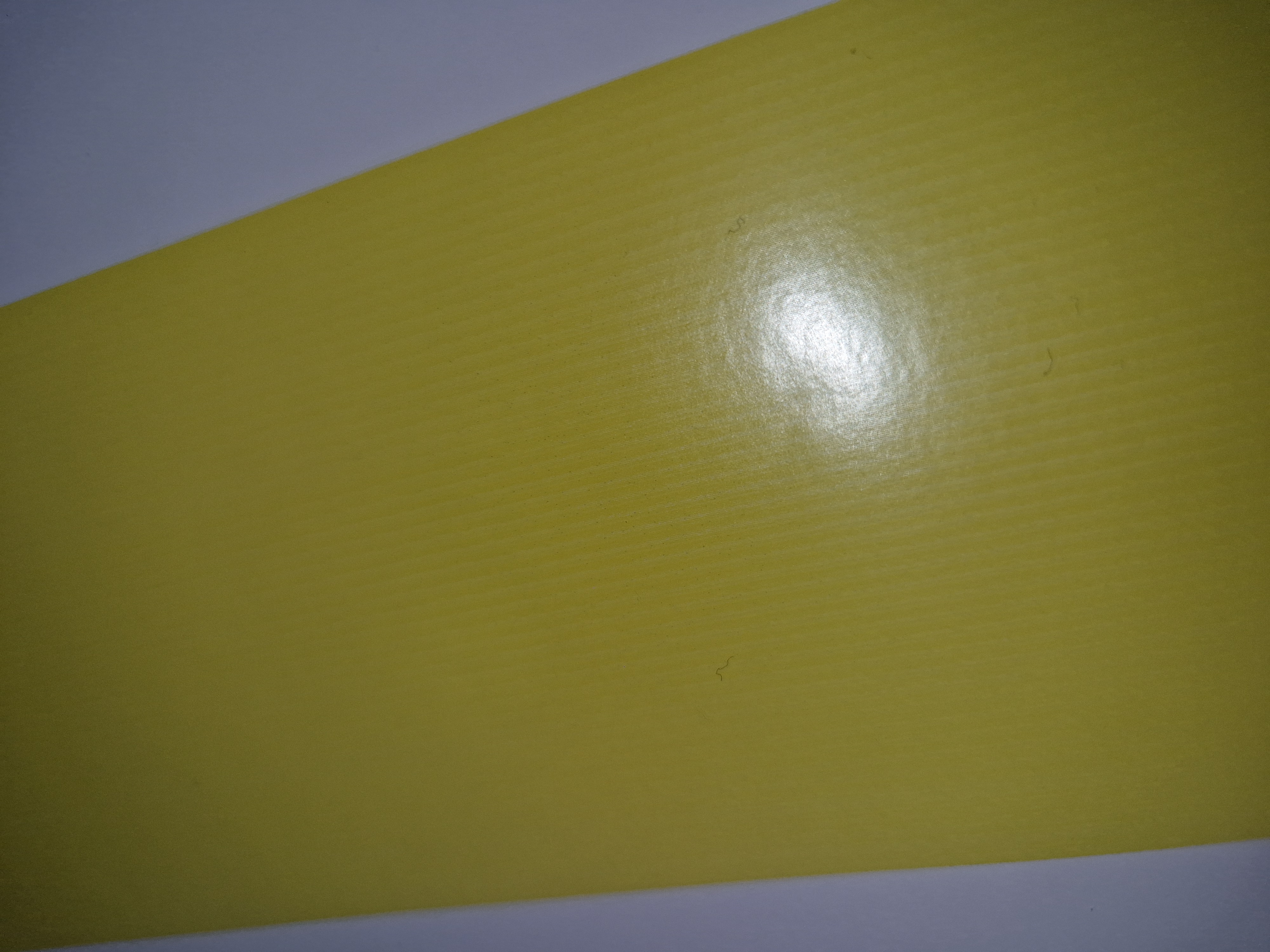

It worked for 2 meters, then the yellow completely disappeared for 15cm, then came back little by little...
sekorse
Hi, do you know how to switch back to max2 ink, as I'm still having yellow problems despite changing all the parts... and I still have max 3 cartridges installed for the moment.
