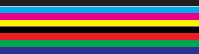

I've had this happen to me at times....usually after a long print. If I don't perform a clean, the first few passes the head has ink starvation and then slowly it starts printing great. I usually fix this with a clean.
However you can't seem to get it to work with a clean no matter what strength. I'd say print this file again after a clean...if it happens again run a nozzle check without cleaning and check the results carefully. If nozzles are fine run a test print similar to the attachment. It's a combination of color bars from cmyk to richKRGB and analize that for dropped color.
You never mentioned if this was a vector or pixel file.....What you can do is test a file in both formats and see what results you get since you mentioned that it didn't happen with blocks of colors.
Before deciding on a profile issue lets figure out if it's a mechanical issue.
