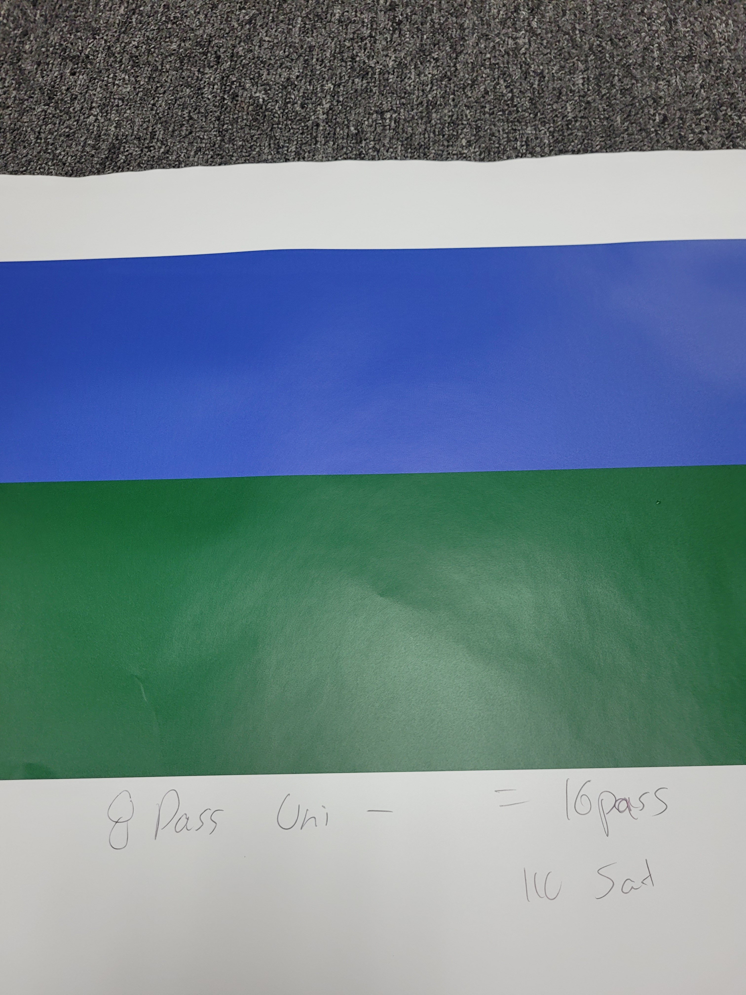

So good and bad news.
I cloned the generic profile and ran an 8-pass UNI with 110 sat (So the equivalent of 16pass) and the Dark Light banding is now gone. So thank you guys for solving that problem!
But in theory this presents and even BIGGER issue in that the only way to get rid of this light dark banding is to use basically an 8 pass uni mode. This means when printing anything of substance the print time on this machine is going to be insanely long.
I've mentioned this to the company we bought it from in that I think this is a problem inherent in potentially all 800W's. I think some customers may have it worse than others, or it may get worse with more time and use?
Hard to say at this point, but at least this gives us a starting point at going back to HP with some updated results.
FYI I've been using this print color sample as its shown up the worst in the green, but the Light dark banding does show up in almost all other colors when we were running other tests. Some a bit more apparent and others a little bit less.

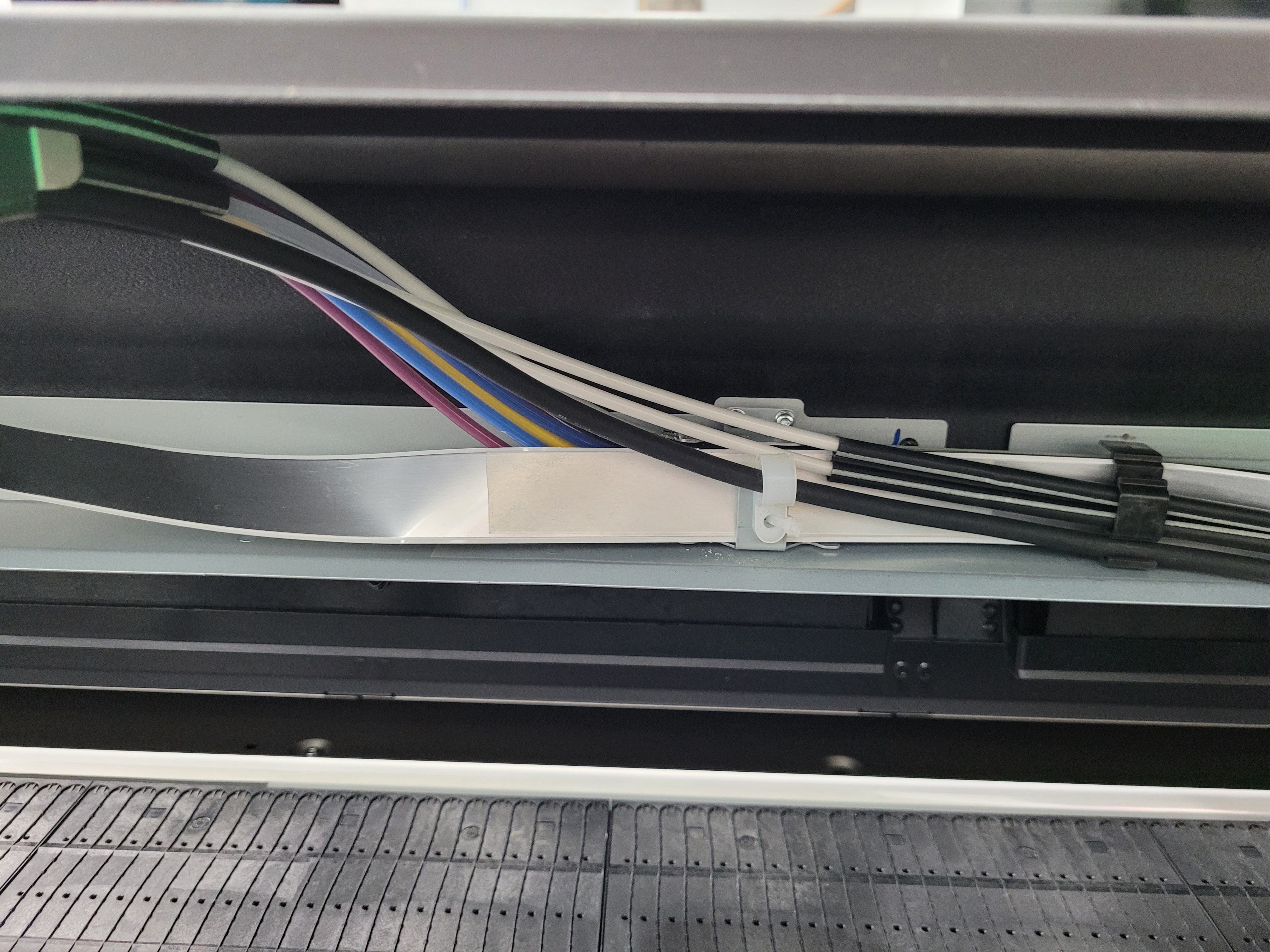

I have had my demo 800W since early March and have installed a 700W and 800W since the demo unit and not one of the three units is having this issue and most of them are running in 6 pass. What firmware do you have installed on the printer? How long have you had the unit?
The only reason I asked about the age of the unit is there was a modification that was supposed to be done to the trailing cables during the installation of the original units. It required removing a zip tie from one spot and making sure the ink lines and cables ran smoothly before putting a zip tie in another spot. If that wasn't done maybe that is the cause of this issue on your unit.

This picture is the new location of the zip tie after everything was checked. The old zip tie location was further up to the left of where this picture was taken. This is in the top middle of the printer being viewed from the backside.

Yep checked and it looks like that clip is installed correctly.

Watch it when it prints and make sure everything moves smoothly. Not saying that is the issue but at least it would be ruled out.
